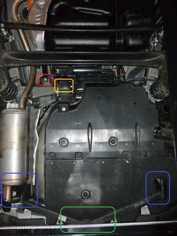

    A few threads semi-covered this but searching showed no definitive answer.
    Has anyone used a hitched mounted cargo carrier for a while with success? Do we know what a reasonable tongue weight is?
    Likely I'll build a brace but didn't see anywhere obvious to mount it to. The yellow area in the picture would be easiest but it does not look strong. Since it's a decent distance back from the hitch that's probably ok.
    It's a while since I installed the hitch. Does anyone know if there is anywhere to secure near the green area? Blue are the only current mounting points; possibly we could add bracing above these to extend the contact area?

    The yellow area identified in your picture is the rear lift point for a floor jack. I think that area is fairly strong :)
    mp3_e46 likes this.

    Oh, a useful reply :) Thanks greatly, a quick Google agrees. I'll did out the manual this evening to reassure myself and get a brace built. Thanks again!
    Likely it's ok without a brace but I am hanging ~200lbs off the back of a 'flimsy' car and driving coast-to-coast so better to be safe than sorry. I've read too many stories of car mounted hitches bending due to overloading with just bicycles. Most prevelant issue is people covering the bikes with a tarp then doing 90 mph+ on the highway

    After thinking about this for a while I am pretty sure I'll drill up into the boot if possible; one or two bolts with long steel plate above should be overkill. Don't want to have the mount bend on us 3,000 miles from home!
