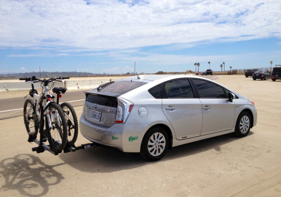

  15. Airstream
    Airstream Junior Member
    Jul 12, 2013
    56
    iplug likes this.
  16. iplug
    iplug Senior Member
    Mar 21, 2012
    2,450
    1,698
    Rocklin, CA
    ----USA----
    Thinking of doing the same here, what bike rack and hitch did you use? Assuming you went with the Curt C11276, right? About how much $, if you don't mind?
  17. markabele
    Mar 27, 2012
    5,084
    1,782
    Nebraska
    Very nice!
    Do you get much bouncing from the bikes since they are set that far back?

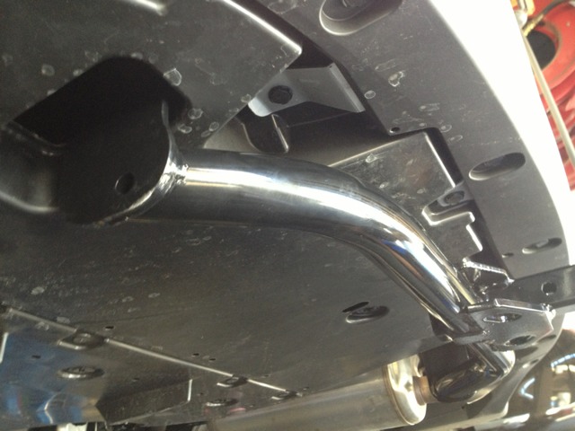

  18. NEinSE
    NEinSE New Member
    Jul 28, 2013
    SE USA
    2013 Prius Plug-in
    Consider (reality check, not trying to burst anyone's bubble, just sayin'....)
    You're bolting onto the ends of the channels you see in the screenshot...cleverly bent/formed sheet metal.
    Toyota bolts only a rear bumper reinforcement onto those channels and spot welds a sheet metal rear cargo floor
    and rear body panel to the two of them. The structure and the skin are engineered to crush in an impact absorbing
    manner. Repairability post impact is a low priority consideration. The plan is also about weight and cost considerations, automated welding, and ease of assembly. A human hair is .003 to .004 thick and the surface panels of the vehicle (hood, fenders, door and quarter panels) are no more than 7 times the thickness of a human
    hair (.030" max.). Keep it simple. Do not do anything/add anything to this mass produced product that Toyota did
    not do/add, and you will mazimize the benefits Toyota engineered into the product you purchased from Toyota.

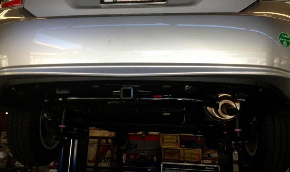

  19. Airstream
    Jul 12, 2013
    56
    Etrailer.com Curt 11276 with Thule T2 and Reese adapter. No noticeable bounce with pinch bolt tightened. 400 miles, 2 bikes...no issues. Happy. ImageUploadedByTapatalk1378172775.198523.jpg ImageUploadedByTapatalk1378172866.997903.jpg
