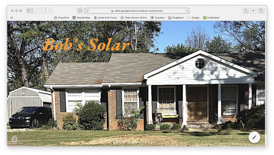

    So this is how the project begins:
    Requirements:
    • Maximum billing, $0.12/kWh, reduction not taxable
    • Minimize power to grid, $0.05/kWh, taxable income
    • Expandable
    Proposed $61,000 solution:
    • 6 kW
      • 400 W panels
    • Integrat with existing emergency generator
      • 16 kW, $0.45/kWh
      • natural gas fueled
      • 30-35 seconds startup
    • Load managing, smart breaker panel
      • 5 kW battery, 16 ms (one cycle) switch to support house load
      • EV charging, work shed, water heater, oven+stove - OFF
      • Lights, gas heater, refrigerator, communications - ON
      • All on when 16 kW generator comes online
        • Solar reduces generator fuel consumption
    I have contracted with "SOLAR Alternatives" for a turn-key solution. Yes, it would be fun to "roll your own" but I am paying extra for their expertise and warranty. Furthermore, at age 74, I really shouldn't be scampering up ladders, laying my own power lines, and replacing the breaker box. They come with integration skills including with the Generac emergency generator.

    First thing I notice is trees shading the roof.
  3. bisco
    115,414
    52,838
    solar companies run computer models of your location and sat photos to show how much power you can produce throughout the year, including average cloud cover and tree shading.
    cutting or pruning may help if they are your trees. some people prefer the shade

    Some leaves on the roof also :)
    Selected contractor will find that this retired engineer will be more 'involved' than average client. Hope they see that as a positive.

    There are two "ground stumps." The larger one nearest the camera held a former pine tree, ~56 years old. The smaller one in front of the BMW i3-REx was some "red berry" tall tree about the same age. I had both removed and hauled off. I have not removed the legacy pine needles since their installation staff can borrow a broom.
    The remaining pine tree on the right shades the master bedroom and two smaller ones. The photo was taken on Friday, November 21, about 30 days ahead of the winter solstice, December 21.
