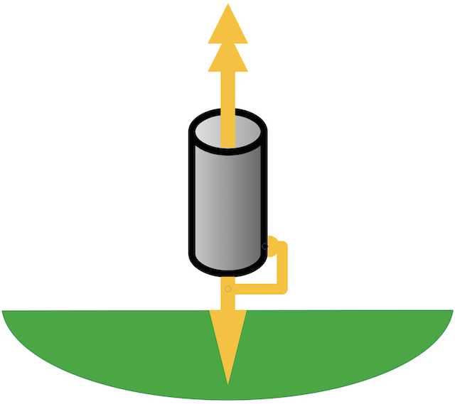

    I have a question for @jdenenberg about running an insulated, heavy gauge ground cable/wire inside a ferrous conduit. Florida lightning research shows that as long as both conduit and cable are grounded at the same earth point, no problem.
    My first thought was the induced magnetic field would be somewhat attenuated by the ferrous, outer tube. This would reduce the magnetic field inducing an electric pulse in the house wiring. Then I thought, "rail gun."
    The high currents should generate a radial force that might make the ferrous tube into a lightning powered, pipe bomb. In effect converting a lightning fire hazard into something worse. But I may be over thinking the problem.

    As far as I can tell, that paper is looking at effects where lightning current is sharing normal building electrical wiring, and wires are insulated and sharing a conduit.
    Your situation is much closer to that in the NEC section on "Enclosures for Grounding Electrode Conductors" (which see). I believe there's a similar provision (maybe even more emphatic) in the codes that are specific to lightning-system conductors, but I'm less familiar with those.
    The gist of the NEC provision is that the electrode conductor is allowed to run in a ferrous enclosure only if the ferrous enclosure itself is made an electrically parallel current path. It must either be an electrically continuous enclosure all the way from where the electrode conductor starts to the grounding electrode it leads to (and connected to both), or, if not, then every segment of ferrous enclosure that the conductor passes through must be bonded to the conductor itself at both the entry and the exit end.
    That may defeat, or partly defeat, your purpose to minimize the magnetic field seen outside, as instead of having the ferrous material enclose something carrying a current, it ends up carrying a big share of the current itself.
    So why do the NEC folks insist on this?
    Inductance.
    A lightning current has a crazy fast rise time, so even tiny inductances in the ground path matter. Every place your electrode makes even a ¼ turn around a corner, well, that's another ¼ turn, adding to the inductance. Count those and minimize. Could a different routing need an even smaller fraction of a turn? The larger the inductance, the more huge the voltage spike seen at the upstream end for such large dI/dt. It can be huge enough for some lightning to give up on your conductor and follow something else.
    A ferrous enclosure around the conductor—when it isn't bonded and sharing the current—is effectively running the conductor through an inductive choke. That's why the NEC guys say nay.
    https://www.ecmag.com/magazine/articles/article-detail/codes-standards-minimizing-choke-effect-understanding-ferrous-metal-raceway-bonding

    I appreciate your insights. So our understanding:
    • We agree the base of the conduit must be grounded to earth along with the conductor.
    I had not considered that a ferrous conduit would in effect make it an inductor that might induce a voltage gradient between the top and bottom, enough to arc over at the top and make it a parallel conductor. My concern was the would the induced magnetic field be strong enough to physically displace by expansion the conductor (i.e., the rail gun effect.)
    From the paper originally cited:
    This leads me to believe any inductive effects on the lightning ground current are weak. But there can be capacitive coupling if not grounded at one end. But this was not my concern.
    So I read up on rail guns in Wiki and realized the ferrous conduit lacks a parallel, return current to make it act like an armature. This suggests a thought experiment. Form a "U" section in the ground wire with strong mechanical bracing and have an armature at the base of the "U" attached to a sign that reads, "Lightning was here."

    Still, the National Electrical Code 250.64(E)(1) explicitly forbids a configuration like the above, bonding the conduit at one end only. It is allowed to be bonded at both ends, or it is allowed to be of nonferrous material. Your choice.
    I believe the NEC editors have reached a different conclusion about the significance of inductive effects. The paper you have found may not be all that they have looked at. They may have interpreted it another way.
    Besides the NEC, the standards specifically for lightning protection installations are directly on point for your project.
    What Are the Basic Differences Between UL 96A, NFPA 780 and LPI 175? | nVent
    Where the NEC is about the building's ordinary wiring, and 250.64(E)(1) puts a requirement on the grounding electrode conductor because it can carry lightning currents, NFPA 780 is what will set out requirements specifically for a grounding conductor meant for lightning.
    It's too many years since I looked and I can't give chapter and verse at the moment, but unless I'm badly misremembering, that standard harps even more than the NEC does about minimizing the high-frequency impedance of the grounding path.

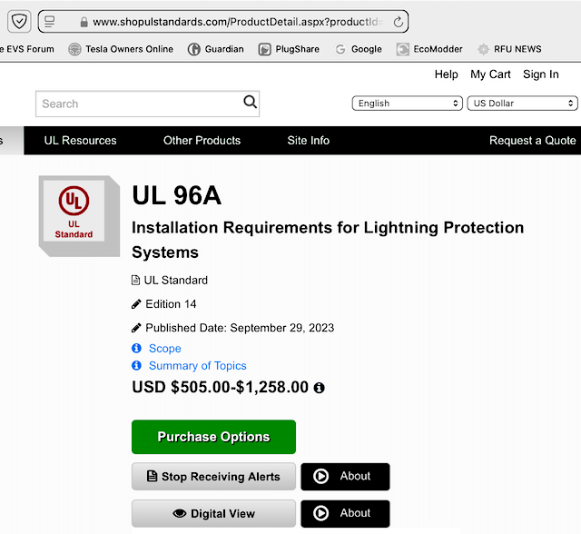

    I would not be at all surprised if a Huntsville Public Library has a print copy of UL 96a and a photocopy machine.

    Yeah, out of the three documents mentioned, I don't know that I would start (or even ever bother) with UL 96A. That'd be for if you want to hang out your shingle as a lightning system inspector. Don't get me started about UL. That's an outfit heavily geared to doing evaluations under $$$$ contract to deep-pocketed customers who need the service. Their document prices are out of this world, and they won't even approve an online account to browse their "solutions catalog" before you explain your employer and job title and how you're going to make them money.
    The ur-standard here is NFPA 780, from NFPA, the nonprofit that researches standards to help stuff not burn down. If you scroll down to the View Free Access button here and find the terms and conditions copacetic you can do that.
    NFPA 780 Standard Development
    Or you can buy it on trees for $157, or $141 if you're a NFPA member (which doesn't require you be anybody special, as long as you think it's nice for stuff not to burn down and willing to support a nonprofit $225 a year for that). Or you can take NFPA LINK ($12 a month or $115 a year for an individual) and view any of 1,500 of their codes and standards online going as far as five editions back.
    The LPI 175 standard is essentially a 78-page crib sheet based on NFPA 780:
    https://lightning.org/wp-content/uploads/2023/06/LPI-175-2023-REV.pdf
    I'm only about halfway through. :) The first 15 pages duplicate the overview web page Trollbait linked. The bond-your-metal-conduit-at-both ends provision (corresponding to 250.64(E)(1) in the NEC) is paragraph 33, found on page 23.
    My partially-formed opinion about halfway through this doc is that the amazon seller you found may not necessarily have read this. I would spend more time reading before installing and before the amazon return window closes.
