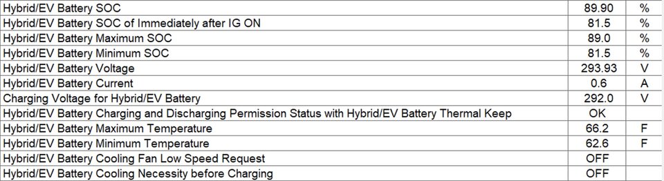

    Currently do not have my Prius Prime at home and will not have it for another ~2 weeks to verify this but I have been using VCX Plus from VXDiag for about a week. The OBDII scanner connects to my NUC running Windows 11 with Techstream 18 downloaded from VXDiag site. The Hybrid Control Module transmits live data from the traction battery. Here is a screenshot from the Hybrid Control Module/ECU from Techstream.
    There may be more data available in Techstream from the Plug-In Control module but I did not screenshot it.

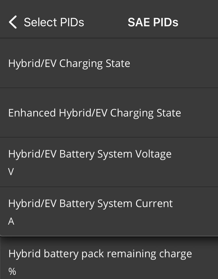

    As far as using a bluetooth only OBD-II scanner tool you probably can get the data above from it but have only experimented with one app OBD Fusion that works with the bluetooth Carista tool. I have not heard of anyone being able to use a bluetooth only OBD-II tool to connect to Techstream.
    Here is a screenshot of the SAE PIDs relevant to battery charging available through the bluetooth OBD dongle I can monitor via OBD Fusion.
    Here is a link to a pdf that shows all of the live data available from the Hybrid Control Module in Techstream 18.

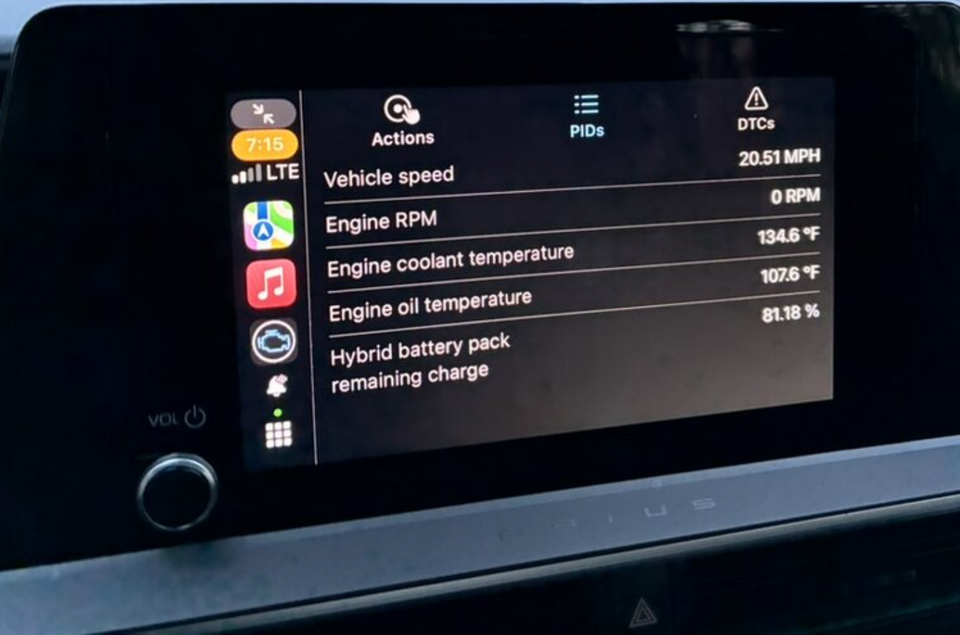

    I have that dongle that I've used with OBD Fusion and Car Scanner. It goes into low power mode after 10 minutes so as not to drain the battery. It is lightweight as well. If I had an ongoing use for the data, I wouldn't hesitate to keep it plugged in.
    Both are apps on my iPhone. Those two apps are CarPlay compatible and display the values noted above on the infotainment screen.
    You would think if it's on your iPhone you could do something with it. But that's beyond me. :)

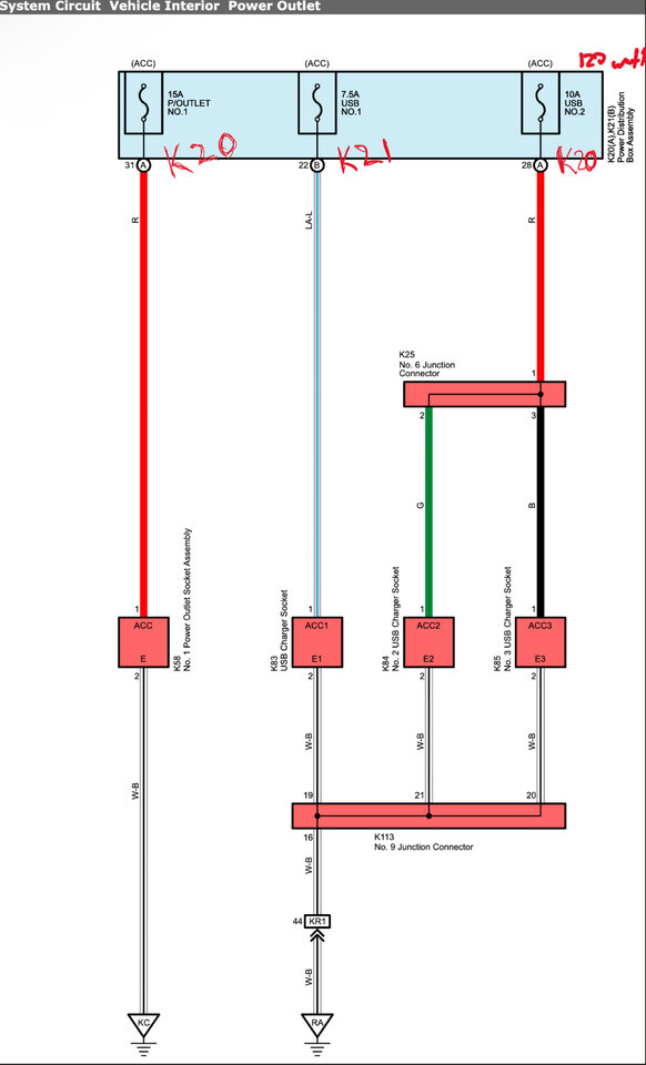

    How much power? Here is a picture of the interior power outlets circuits.
    For the 15 amp roughly 180 watt cigarette lighter outlet AliExpress sells connectors with bare wires spliced in so you can add a circuit without having to cut the OEM wires. Here is the link to the product on AliExpress.
    https://a.aliexpress.com/_mKigwjr
    These circuits do not provide power when the car is powered off. If you want it to have power when the car is off I think you would have to add a circuit directly from the 12V auxiliary battery in the hatch.
