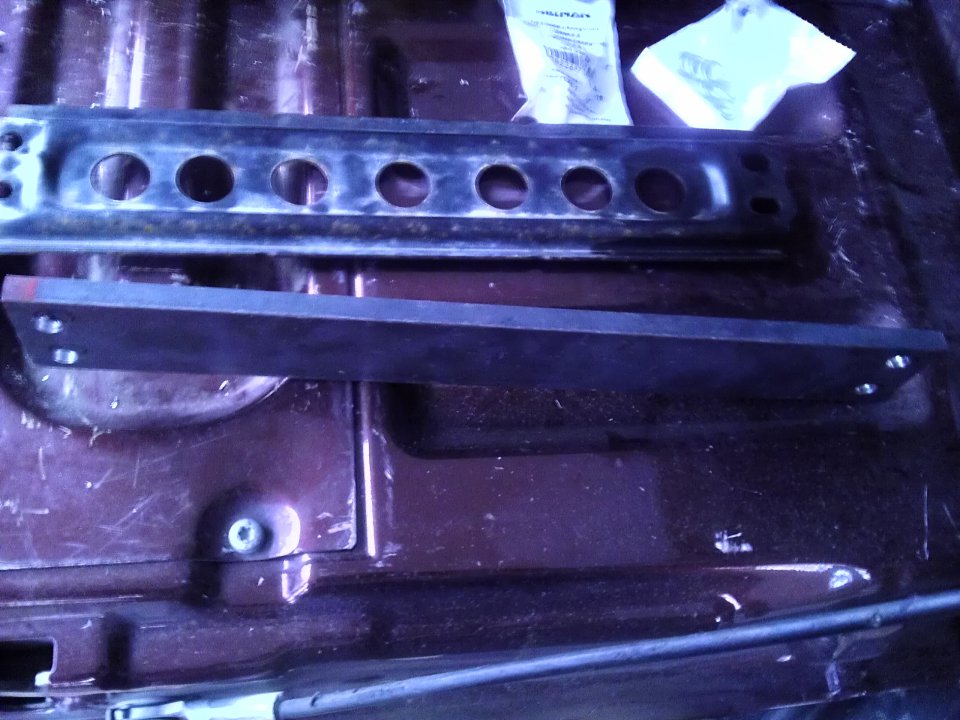

    Newbie here! So yesterday i was reading about the wonders that a rear chassis brace can do for the Prius. So i was like "what the heck, i'll just make one my self.. who wants to pay $50 and then have to wait around for shipping?" So i went to Lowe's and bought a 3 foot section of steal, some new washers, and 4 new bolts. I only needed about 1 foot of metal, but thats all they had had, so i had to pay $20!! but hey still better than $50! How to: Used a band saw for cutting to proper length, then used cordless drill to drill the 4 news holes. Bam you're done! Really noticed a difference in highway steadiness, love it! Will try to upload a picture later, this Mac is being a stupid.

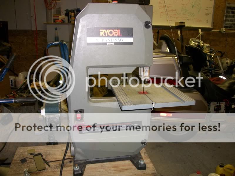

    this is a bandsaw.
    nice job by the way. :)
    Jason

    Depends on the band saw.
    Most wood cutting band saws are too fast and would likely burn up the blade.
    I have 5 metal cutting band saws in my shop and one for wood. I'd NEVER use the wood one for steel.

    I actually did! I too was a little skeptic of what other people were saying on Prius chat. It isn't night a day though, I only really notice it on sharp turns(stays a little falter and maybe more control) and high speeds 70-75 mph. This really helps if you drive on a interstate like me that has a lot of cross winds. Oh one more thing, its more relaxed at higher speeds, making it easier to drive with one hand! Hope this helps

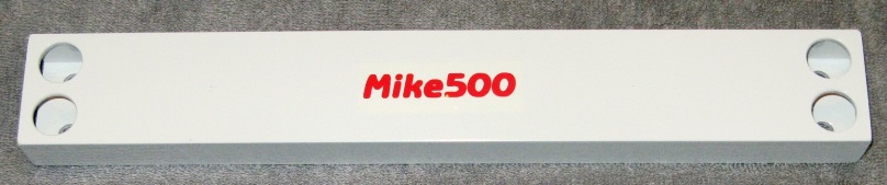

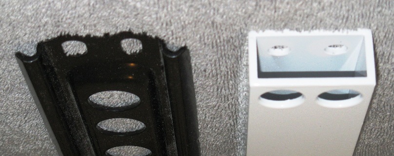

    Over the past two years, I developed the "box beam" version of the center brace. for both the Gen III and the Gen II.
    The aluminum "box beam" has the ultimate stiffness, without the added weight. It weighs within three ounces of the original, NOT the 2-1/2 pounds of the BT Tech Plate or the G7 plate. The "box beam" has the "flex" required as in the original to prevent stress damage to the sheet metal mounting points of the thin sheet metal steel rails.

    Thanks! I just used a cheep ratchet, don't remember the size though. Just like tightening any other bolts, no special tools like an air ratchet required.
    And sadly i don't have a strut tower brace :( i'd sure like one though.. I think that would really help in the handling department! Maybe one day i'll get one, right now I'm to cheep.

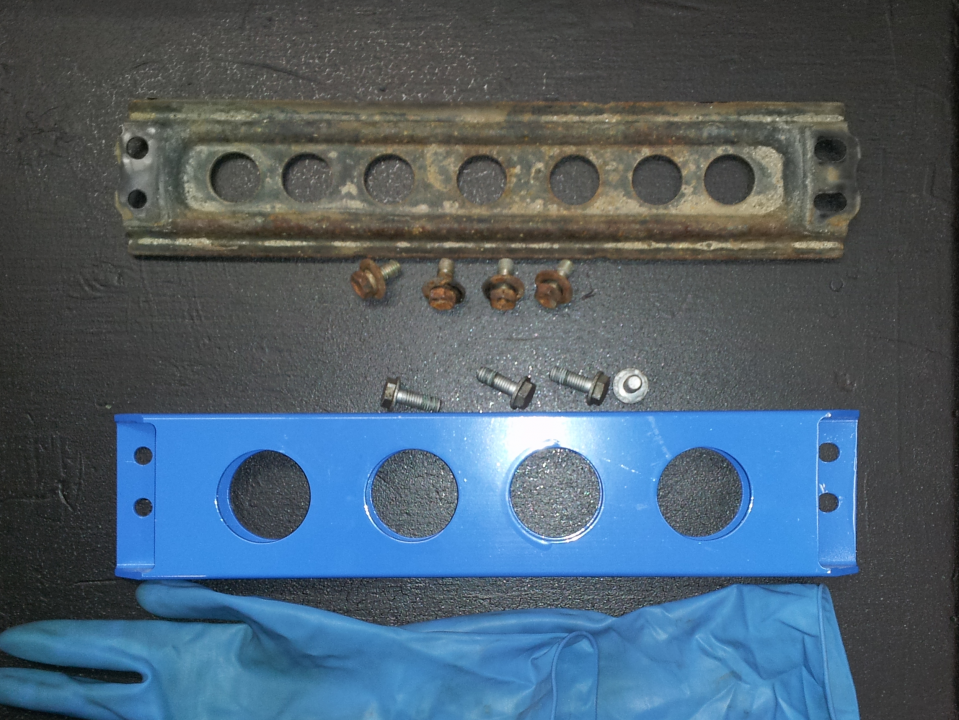

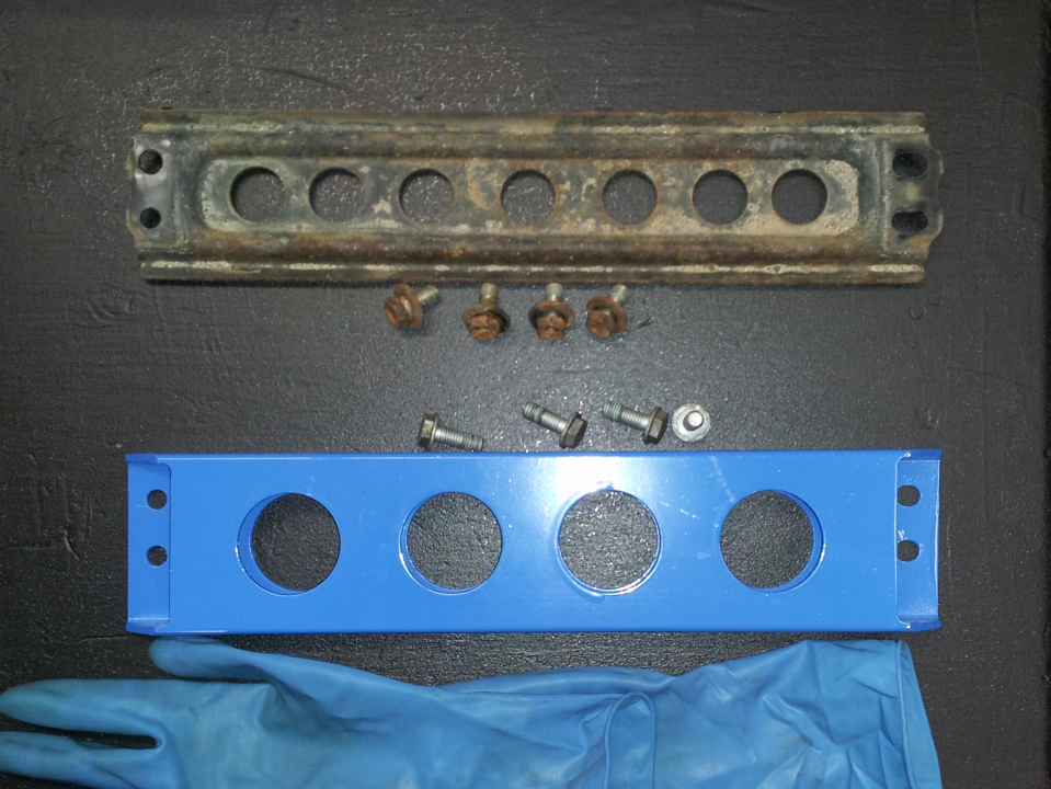

    PriusBrace.png so this weekend I installed a very cool looking blue box-beam chassis brace on my car. sure looks good, fit was perfect. will it help? FIIK. it was easy and the bolts came right out with a cheap 12mm wrench. (I seem to have lost all my 12mm sockets) I was concerned cause my car >10 years old w/ almost 200k, and the local govt retards use our tax $ to spread about 6 times as much salt as is needed every time they think it might snow.
    started all the stronger bolts and finger tightened em before cranking them all to about 25'# with a 13mm socket.
    I hope to report back that it does in fact help. but it sure looks cool.
  20. Aaron Vitolins
    Aaron Vitolins Senior Member
    Feb 28, 2014
    1,612
    1,145
    Franklin TN
    That looks really nice! Gotta say your old brace looks a little more dirty then mine, I guess we don't get much snow down in Tennessee.
    Where did you get your nice new brace? and how much?.. can't wait to hear if you notice any difference
