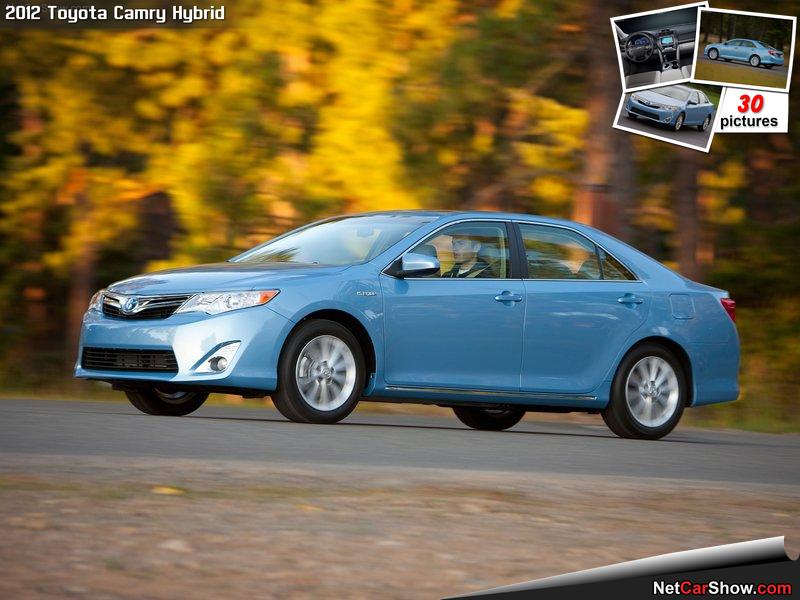

  15. cycledrum
    cycledrum PSOCSOASP
    Apr 9, 2008
    8,246
    1,202
    NorCal
    Awww, look at Toyota's signature Baby Blue color for the Camry Hybrid - Baby Blue.jpg
    :ROFLMAO:
