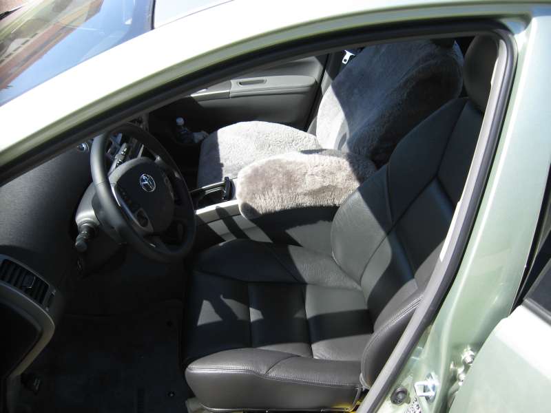

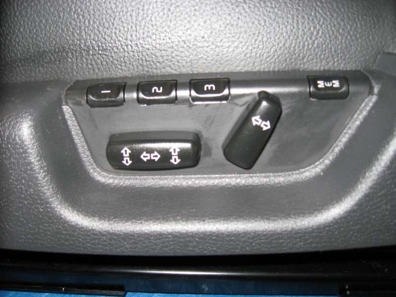

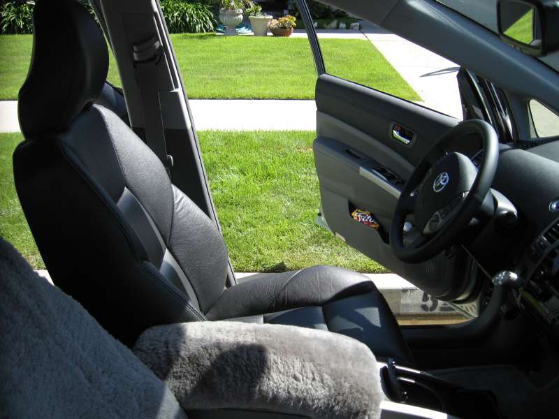

    Actually you haven't really busted your butt to make the Prius seats better. ;)
    Right about the time you joined PC, there was another PC member who truly showed what upgrading Prius Seat comfort is/was all about. I give you ... the cushy Volvo seats:
    All that to say - there are a few comfort nazis out there that have really REALLY gone the extra mile when it comes to fluffing up the Prius comfort level.
    Here's the thread that talks about all the effort going into the mod:
    Operation Volvo Seats in a prius | PriusChat
    I added more back support foam (for my 6'5" frame (as well as the 'extend my seat' mod) - and seat warmers. That did the trick for me. But if it hadn't ... this would have been the next step.

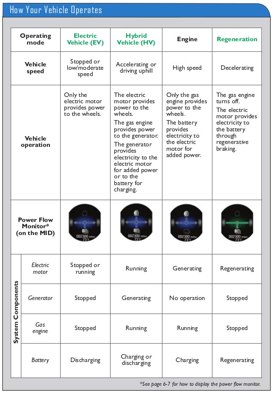

    Thank you for the links. The Car and Driver made it clear:
    1. Is the computer varying the relative amount of power contributed by the motor and engine above 43 mph, or are there other tricks in play? In steady state, it is a serial hybrid at low speeds. When the clutch closes at higher speeds, it becomes a combined parallel and serial hybrid. This means it can add or subtract as much power from the electrical power system as needed.
    2. How can the single gear setup (what 1 article likens to a 6th gear) operate efficiently across such a wide range (43 to 114 mph)? It is the advanced engine valving and cooled, recirculated exhaust. The short duration high power comes from the stored battery energy.
    At low speed, the serial hybrid drive train will be relatively inefficient BUT the high efficiency, engine will help compensate. It is a clever solution but the Toyota system will always be more efficient at low speeds because of the power split:
    • Honda drive train at low speeds -> 92% * 92% ~= 85%
    • Toyota drive train all speeds -> (28%*85%) + (72% * 98%) ~= 94%
    • Honda drive train at high speeds -> ~98% minus whatever proportion the electric path adds
    Given identical engine efficiency, rolling and aerodynamic drag, the Toyota has about a 10% advantage at low speeds. At high speeds, the Honda clutch coupled engine will have a 4% advantage. Pick your poison.
