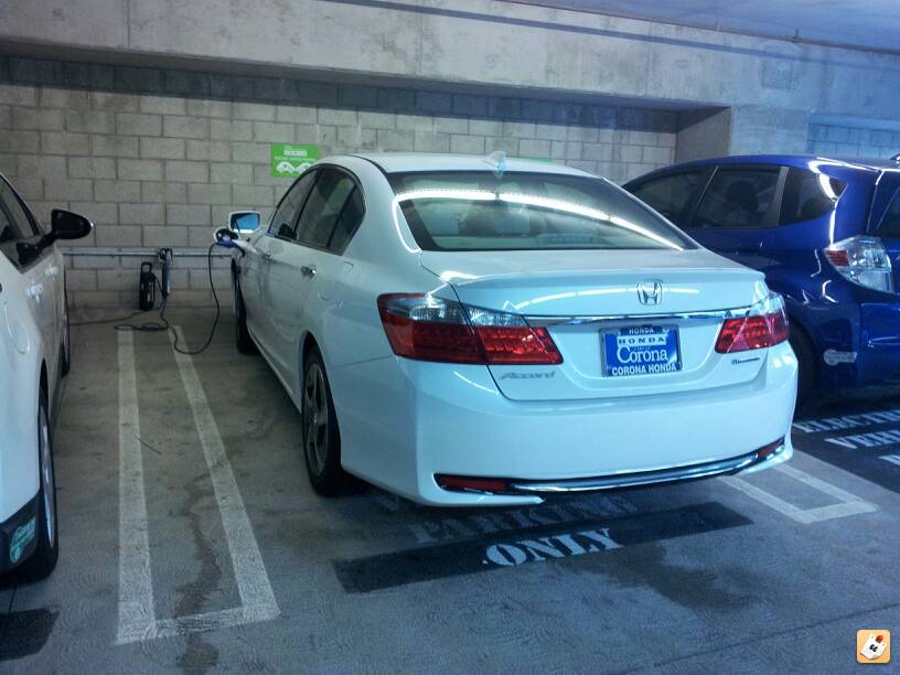

  6. hill
    21,208
    8,800
    you could have fooled me because I think I took this picture at work about a month ago ... and maybe posted it here on this forum in another thread the same time frame ;)
    I'm just sayin' ...
    BTW, the owner let me test drive and I felt no more comfortable/uncomfortable in its drivers' seat than then I do in the generation II & III Prius. And as I've mentioned before - height wise - I'm about 6'-5" tall. normally I don't argue seat comfort because it's subjective - some will find one seat horrible the other finds it to be just fine. Sothe people who think their comfort situation matches everybody else .... well they just don't get it.
