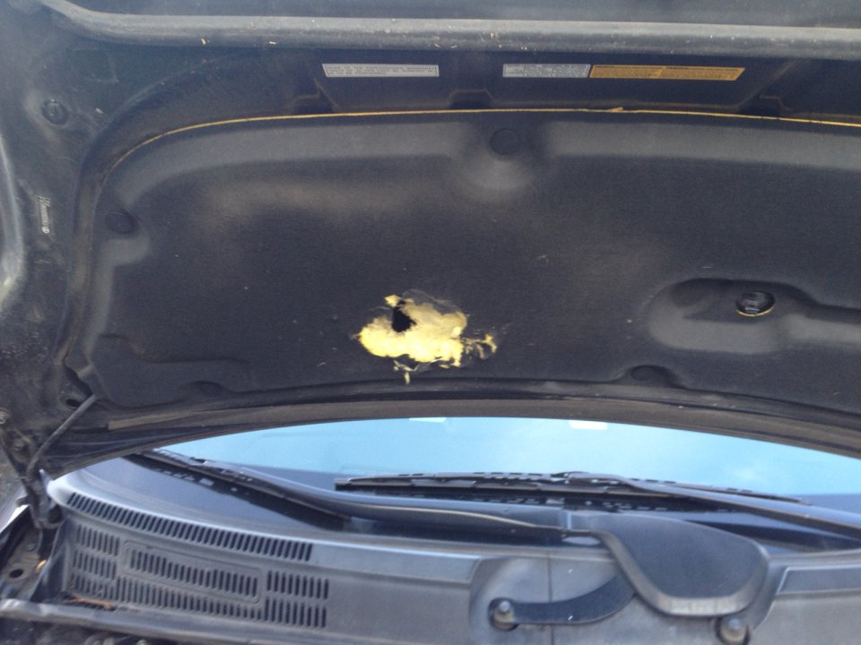

    Greetings,
    A while back, while on a trip some relatives had possession of my '09 Prius. All was well until I discovered a little friend had been visiting under the hood and lucky only left a small mess to clean up...
    A nice sized hole in the heat shield of the hood :(. In researching a replacement part on the used market the cost is around $170+. I'm planning on replacing it someday, however in the mean time I'm looking for a tape that would adhere to the fibrous fiberglass piece to make it less of an eye sore.
    Anyone have any idea what kind of tape I would be looking for? Duct tape branded tape won't adhere.
    Again lucky the only damage left was the hole in the heat shield of the hood.
    Thanks for any and all your suggestions.
    -Mike

    Maybe just take it off (to avoid risk of overspray) and spray-paint it with some flat black? Gives the car character. ;)

    gorilla tape. i've had it on my grille cover all winter with no sign of failure.

    Remove the cover. Tape a sheet of grease proof paper over the hole, and rest on a suitable support to hold the paper flat. Spray into the hole from the top side with expanding foam from a builders merchant. When set, trim off the excess on the top, remove the paper and spray the area mat black.

    I second the gorilla tape or the method BritPrius recommended. OR buy one on ebay from a salvage Prius or a local junkyard (search car-part.com), that is, if you absolutely must have a new one.

    Sadly the gorilla tape won't stick either :(. Looking into the other couple of ideas once the weather gets a bit nicer.
