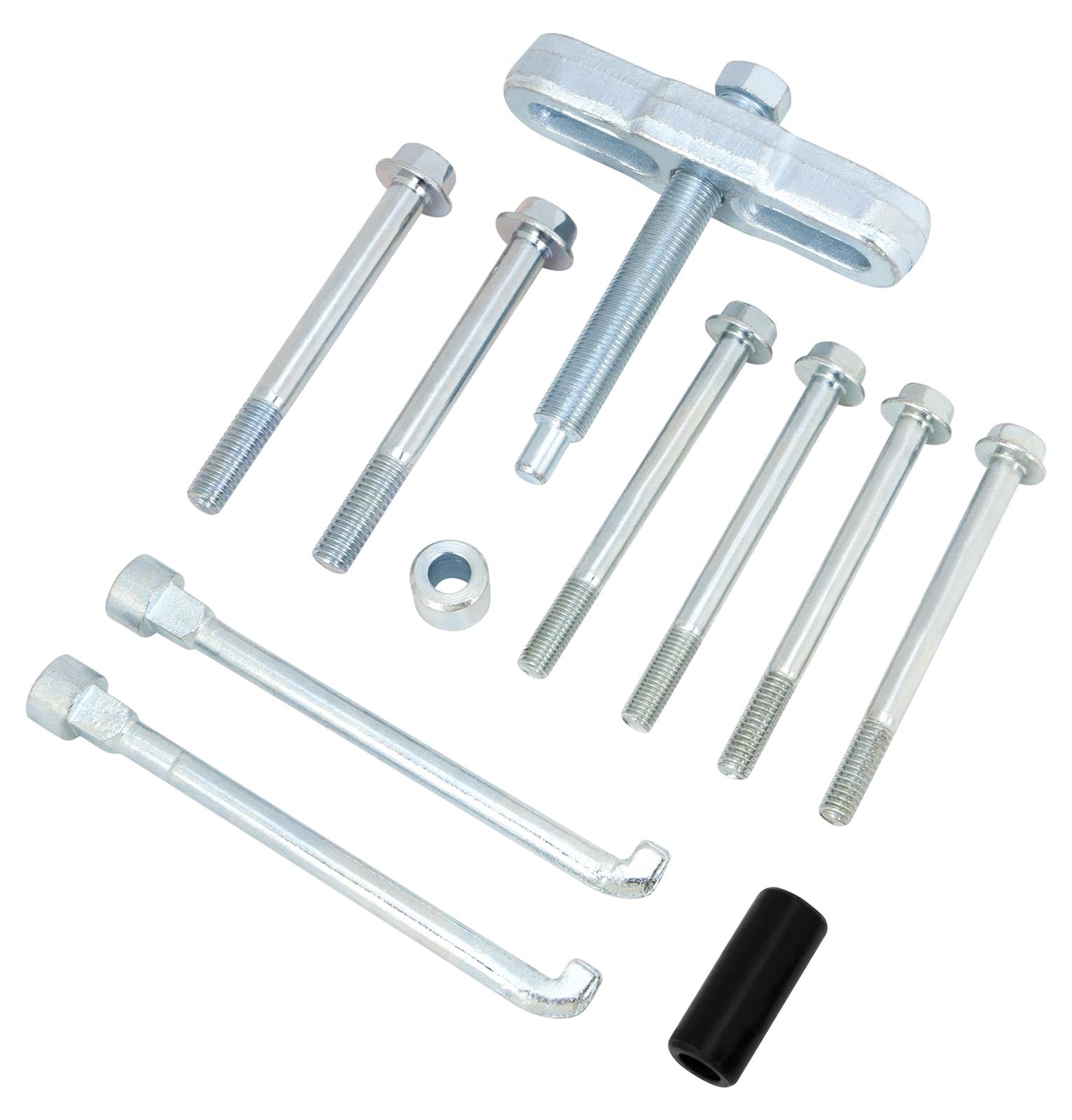

  11. ChapmanF
    27,284
    17,899
    A steering wheel puller.
    Once you have removed the airbag and the nut on the column shaft, you'll see that the steering wheel has two threaded holes in it, on either side of the column shaft.
    Using two of the M8 x 1.25 bolts in the puller set, you thread them through the puller into the wheel's threaded holes. (It comes with different sized bolts and maybe hooks or what not, so it can work with a variety of cars.)
    Then with a wrench, you slowly tighten the big bolt in the center, which will push straight down on the steering shaft, and pull the wheel straight off. Usually it will resist for a bit, and then come loose with a pop.
    This pulls it straight off without damaging the splines in the wheel or on the column shaft.
    Sometimes you read about (or watch on youtube) somebody who just takes the center nut off and just grabs and jerks and yanks on the steering wheel until it comes loose. You might get away with it. You just have to ask yourself one question.

    I've pulled about a dozen Gen 2 steering wheels in salvage yards. I used a puller on the very first one. The rest I did just by wiggling and pulling, so it can be done if needed. Puller is much safer and gentler because wiggling and pulling can snatch on wires if you're not careful.
    And here's another idea. After you remove the nut, you can mark the shaft and the wheel to help with alignment.
