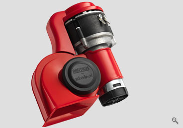

    I just installed the Stebel Brio (La Dolcé Vita) model in my 2010 IV. I had a previous aftermarket horn (with horn relay installed), but the horn malfunctioned. I had to fashion a small extender bracket so it would fit (otherwise the hood would not be able to close), as this is a much larger horn. It is attached with a single screw to the bracket behind the toyota logo, in front of the radiator. (this mounting spot is designed to house the radar for the Prius technology package). The horn works great and is a real head-turner. And causes smiles because the sound is so unexpected.
    STEBEL® ITALIA - Trombe Horns
