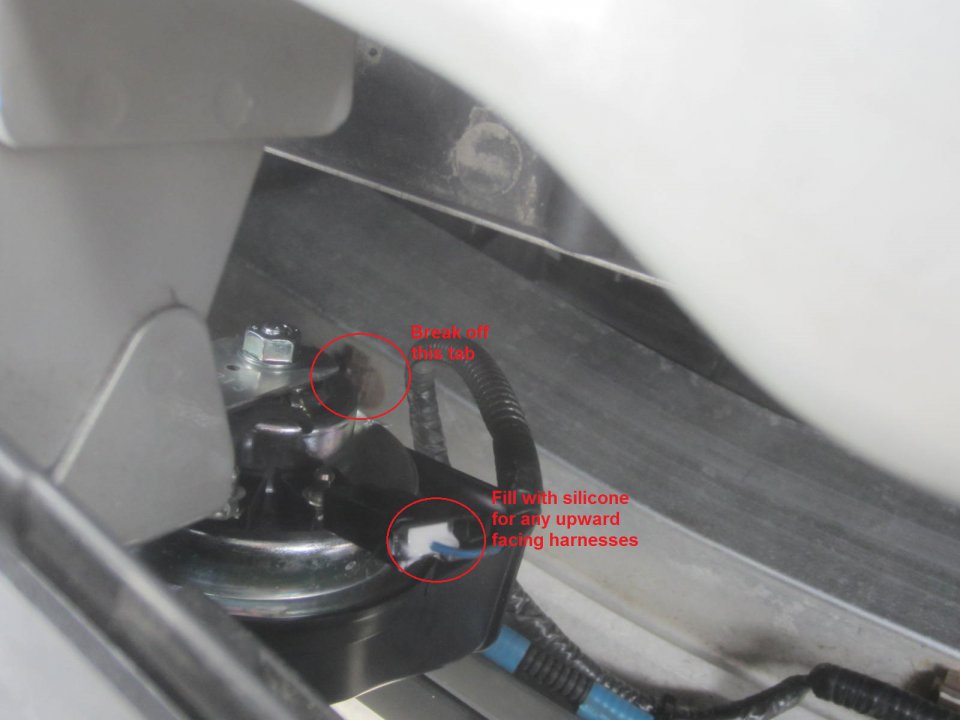

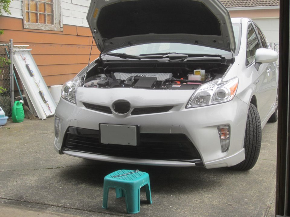

    I just installed the horns today on my Prius. It was not difficult but I have a bad back so bending over the engine compartment was not fun:

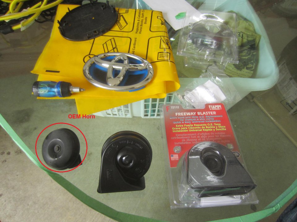

    I had no idea the OEM horns were so small! Anyhow, on with the pictures. Because I am a worry-wort when it comes to the car, I questioned weather or not the new install would stand up to the elements. The install was not straight-forward because on the new horn, the connection clips did not face downwards. I had to remove a wire securing clip which attaches the wire to the bumper so that I would get more length to connect power to the horn.
    So as you can see, I had to break off the tab holding the wire in place so that more length could be used to connect to the horn's terminal. I also filled one of the connectors with silicone since it was facing upward and could collect water.
    Actually reading over some of the posts here, it looks like some have run into reliability issues with the connections. I will have to take off the emblem again in the future and start coating everything in silicone...lol.

    ^^ Couldn't you have just rotated the FIAMM horn so that the terminals would be reachable? Or move the ground wire to the terminal that's furthest from the car's harness?

    I could rotate the horn but then it would face upwards and possibly collect water. Tried moving the ground wire around too. It would just be simpler if they made it so that the terminals on all these horns faced downwards!

    Gotcha. I just thought I'd ask because for me, the horn faces down and the harnesses still has a little bit of extra slack.

    Once I got them out, my first thought was "man these stock things are dinky!"
    Thanks!
