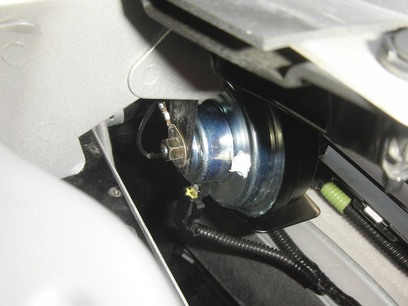

    Not sure if u got the right or wrong horns but to get them to work, the oem connector goes on 1 of the spade terminals. The other terminal on the horn need to go to a body ground (the both that the horn bracket bolts to) & they will then work.

    Thanks, guys. I tested them and they worked when grounding the 2nd spade. Since they work I went ahead and installed them, in spite of my earlier-expressed concerns about the seemingly different appearance & number of spade connectors than others who got the El Grande horns.

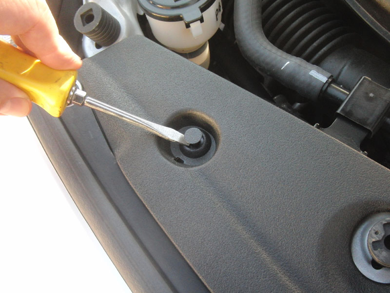

    I wanted to post my steps for a 2015 Prius Model 2...
    OK... I'm a pretty good DYI'er as others stated.. I read all 19 pages in this thread.. Went out and tried to install, and couldn't do it..
    Re-read again, printed out some pic's / written instructions and DID IT !!! YEAH.
    So, 2015 Prius Model 2..... FIAAM El Grande pair of horns..Each horn only had one "spade" lug to attach the removed plug from the OEM horns. I DID NOT HAVE A SECOND SPADE LUG to attach a ground wire, so as stated, the nut/stud on the side of the FIAAM is used as a ground to the frame.

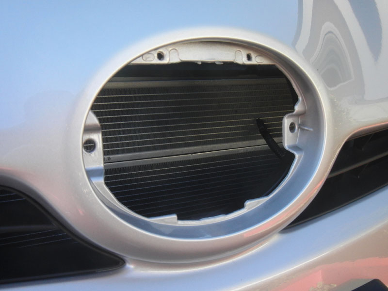

    1) removed the first small plastic shroud with 3 plastic pop up clips
    2) removed the 2 bolts and several other pop up clips on the top of the next shroud/bumper to give about 3-5 inches of room to get my arm in.

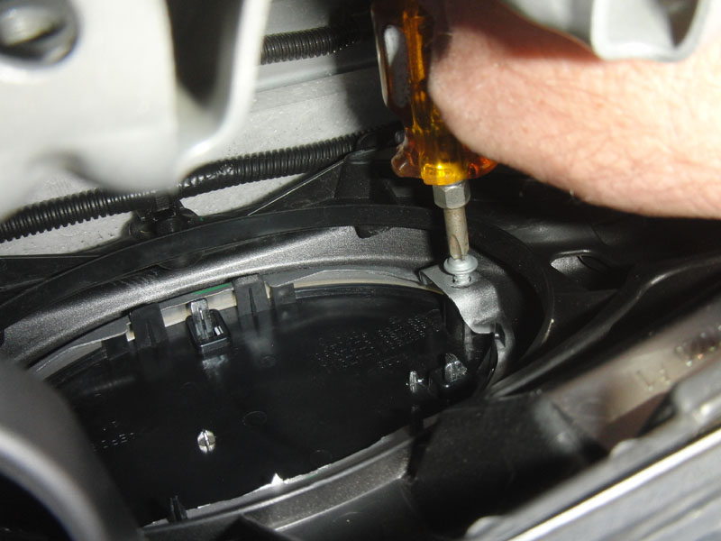

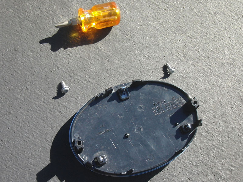

    3) removed the Toyota emblem with 2 screws
    These 3 steps literally takes no more than 5 minutes.. just do it, to give you extra room.
    4) layed a piece of carboard in front of the radiator in case I dropped something into them....Oh, remember to remove it before buttoning everything up at the end.. yes I forgot about it !!!!!! LOL
    5) wedged a piece of 4inch x 4inch cardboard under the top shroud/bumper and frame so I didn't have to use a hand to keep pulling it out.

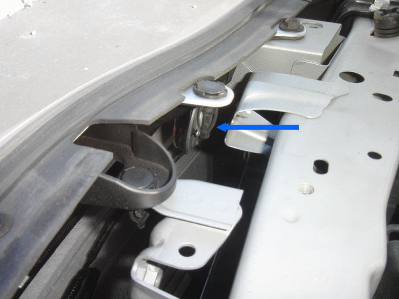

    6) removed the bolt on both horns (and some other sensor that was next to the passenger horn) to remove OEM horns.

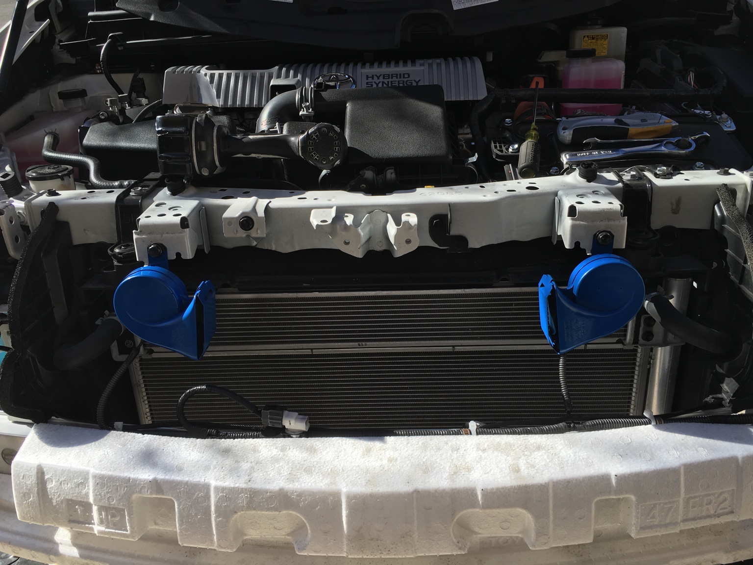

    7) installed FIAAM provided bracket onto new horns with provided nut, and added a lock washer (as someone else stated) at work bench. Also removed the red cover as it was facing the wrong way to see from the front of the car and it layed up against the radiator.
    So the "black" side of both horns face the front of the car. They would not fit having the red cover side face the front or the radiator side of the car.
    8) popped out the cable clamp on the power cord to the passenger horn from the frame to give more length, as the new horns will have one of them facing the wrong way. Seemed easier to do on the passenger side instead of the driver side.
    9) bolted in both horns, and plugged in power cords directly to the new horns that have a spade lug. Bolted back the sensor on the passenger side. The passenger side was more difficult to get started than the driver side.. oh well..
    OH, I dropped one bolt, and was able to reach it thru the opening where I took out the TOYOTA emblem.

    14) reinstalled the small shroud with the 3 pop up plugs and.............
    TADA... sorry, but this all took me about 45 minutes..
    Again, just wanted to update the procedure for my make/model/year vehicle to re-assure those that have read this thread..
