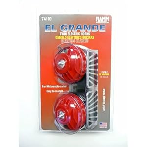

    After a close run in with a SUV on the highway, I too upgarded the horns to Fiamm El Grande's 2-pack. $19.99 at Amazon.com. Thanks to the OP and all others that contributed to this post.The install went perfectly and took all of 20 minutes.
    Some notes on El Grandes:
    - No jumper wires needed
    - The drivers side wire length was spot on.
    - The passenger side required that I cut one plastic wire loom retainer to gain a bit more length
    - I rotated the outlet of the horns to aim out the upper grille rather than straight down. Seems louder that way
    - I left the red covers in place (they are removable). You can't see the red from the outside of the car
    - The chrome outlet grills I did remove as they were visible through the upper grille
    - Great MOD and at 20 bucks, extremely affordable and cost effective
