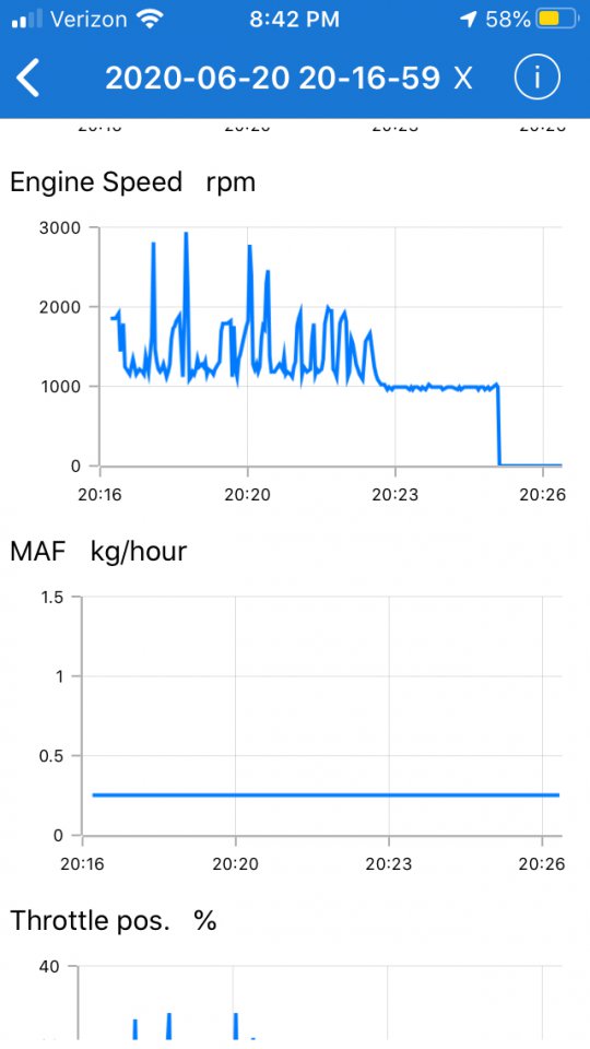

    Why, yes ... yes, it should. It, um, should be showing more air going in when the throttle opens more or the engine works harder, and less when it doesn't.
    There's a possibility that "Car Scanner on iOS" just doesn't know how to get your MAF reading, but that seems a remote possibility. MAF reading is a standard PID that any self-respecting car scanner should be able to read.
    That leaves the possibility that your ECM is getting a fixed unchanging reading from the MAF sensor. That would mean your ECM has no clue how much fuel to inject to make a combustible mixture, which will result in horrible noises (which you have) and codes about misfires (which you have) and about poor engine power (which you have, P3190, which has the MAF sensor as one of its suspect areas) and failure to start (P0A0F, likewise).
    A voltmeter on the MAF sensor output would answer some questions the audience following at home surely have.
    It's odd that you don't have (or haven't reported) any of the codes specifically reserved for a wacked-out MAF sensor (P0100, P0102, P0103). But those codes are looking for a sensor output that's either below 0.2 V or above 4.9 V, so clearly out of range.
    Yours just looks like it's humming along at a never-ever-changing, oh, 250 kg/hour, eyeballing your graph. Toyota gives their ranges in g/sec, so 250 kg/hour is around 69 g/sec, which is right in the expected range of MAF values. So no P010x codes.
    It sure isn't useful though. If your ECM had a way of knowing how much air was going in, your engine would run better.
    There's a cute note in the repair manual next to the expected range (1.0 to 270.0 g/sec). The note says "The value must be changed when the throttle valve is opened or closed."

    LOL... whelp, one thing it could be is forgetting to plug the MAF back in after having taken the assembly apart for the third time today. Sigh.

    Here are three shots of my Prius maf and rpm using Car Scanner for IOS. Is it possible your scale units are set wrong in the app? (Edit: These were taken with "forced charging" in the driveway - zero speed - first two with changed throttle position)

    Hmm ... while the range given in the manual is from 1 g/sec minimum to 270 g/sec all-out, if rjparker's readings were all around 7 g/sec (presumably idling, or just revving the engine in the driveway), then a fixed 69 g/sec reading out of the sketchy one would look to the ECM like a moderate respectable load. Well, about ten times what it should be at idle. Which would make the ECM inject a lot more fuel than it ought to.
