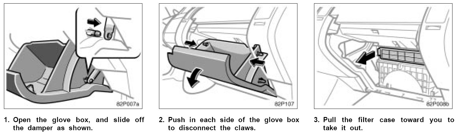

    I don't it is your filter since you did not state odors were coming from the vents but does not hurt to check. If should be in the engine compartment some cars it is located over the 12 volt battery ( that is on Mercedes Benz's that is )
    Quick Google Check, looks like behind the glove box:

    sorry, no. but someone with a c will chime in. in the meantime, you can search key words and phrases.
    the cabin filter in the lift backs is accessed by lowering the glove box door. after opening it, you press in on the ends to release the stops while applying slight downward pressure.
