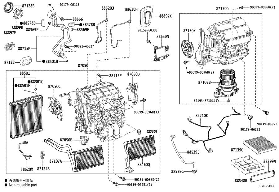

  20. ChapmanF
    ChapmanF Senior Member
    Mar 30, 2008
    23,843
    15,496
    Indiana, USA
    Looking at this picture, pay attention to the little servos (callouts 87050C, D, and E, and 87130K). Those are what move the doors around inside that box. Different doors do different things: select where the air comes in from (fresh or recirculated), select where it goes (feet, face, defrost, ...), and control how hot it gets (by mixing or blending how much air goes through the heater core and how much goes around it). It's that last one that can lead to this kind of symptom, if that door is stuck in one position and the air is always going through the heater core.
    People call that one the air mix servo or the blend door servo. (Some people kind of call all the servos "blend door" servos, but of course that's the wrong name for the other ones.)
    HEATING & AIR CONDITIONING - COOLER UNIT. 2017 Toyota Prius Prime | Toyota Parts Center Online
    Unfortunately, that parts list does not name the different servos clearly enough to tell which one is the air mix servo. I've noticed that before, even with earlier models; between engineering and the parts catalog, somebody always mixes up the names of these servos. This list is calling "air inlet door actuator" the one farthest from the air inlet door, and I really doubt that's right. ;)
    The place to see which servo really is which would be in the repair manual or the new car features manual, both described here:
    Toyota Service Information and Where To Find It | PriusChat
    Although the servos aren't very expensive, there's no getting around that a lot of dash disassembly might be needed to get down there. The dash really is made to come apart, more easily than it looks, but there are a lot of steps and it's tedious, and expensive if billed by the hour. Also, the 'smarts' of the servos really are built into the little wire harness, 82210K, so sometimes that's where the problem is.
    Finally, sometimes the case is that the air mix door or its shaft really did break or jam up inside the box. Those parts aren't sold separately, so if that's the issue, Toyota really wouldn't have any fix short of replacing the whole box.
