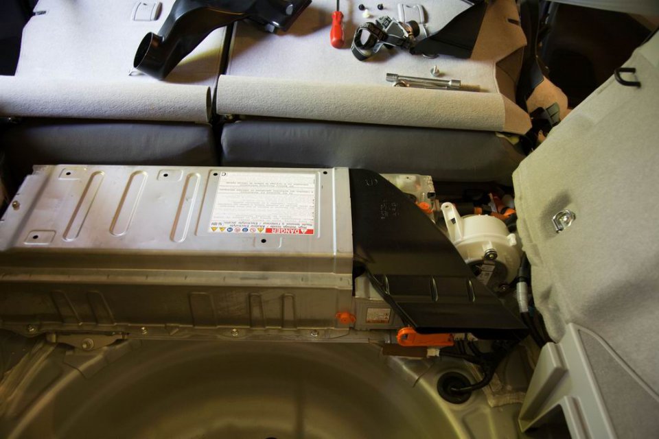

    Have said this in another post, if you take it apart to clean it and you use compressed air hold onto the fan and don't let it spin. It can generate a current and blow its circuitry.

    I've also said this in another post. It cools significantly better if you set it to flow-through not recirc. Tested this and posted the results.

    So is there a sensor in the fan to turn on to cool the battery at a certain temperature?
    Would this also work to warm it in the winter as well?
  9. Mendel Leisk
    61,519
    42,330
    ^ There's a temperature sensor somewhere in vicinity of the hybrid battery, and yes it's controlling the fan. It would only be for cooling.

    Where does the air to cool the battery go after it passes over the battery, and when there has been air passed over the battery where does the fan continue to draw from?

    Not necessarily! Opposite opinions are not unheard of here.
    What Feri said makes sense to me. If you set to flow through, the a/c fan will be drawing air from outside and slightly pressurizing the cabin. The air will need to escape from the cabin and will follow the easiest routes. If the windows are closed, the path through the battery fan may be the easiest route. You can think of it as a mild turbocharge for the battery fan!
