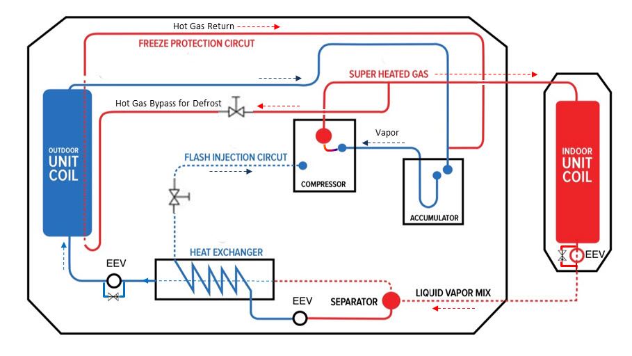

    There are now more elaborate and expensive heat pumps that maintain their rated btus down to 5f and a couple are down to -5f.
    But they come with a couple of penalties. First these "hyper heat" inverter based units, initially designed by Mitsubishi, have the ability to overspeed their compressors as it gets below 35f to maintain their rated btus (maybe 36k, 48k or 60k btus). The penalty is the normally quiet and efficient "hyper heat" compressors get very loud and start using high amounts of power. The indoor blowers also speed up beyond normal - all in an effort to maintain their rated heat. Just maintaining their rated btus is often not enough as the heat load increases in severe weather. Especially in existing housing without super insulation and air sealing.
    The "hyper heat" models cost significantly more than other "inverter' based models, are far more complicated with extra metering valves and plate heat exchangers to provide special compressor vapor injection and hot gas defrosts.
    Importantly, most hvac techs can't repair them without exchanging expensive inverters and control boards. Which generally are not on their truck and may not be at the local supply house.
