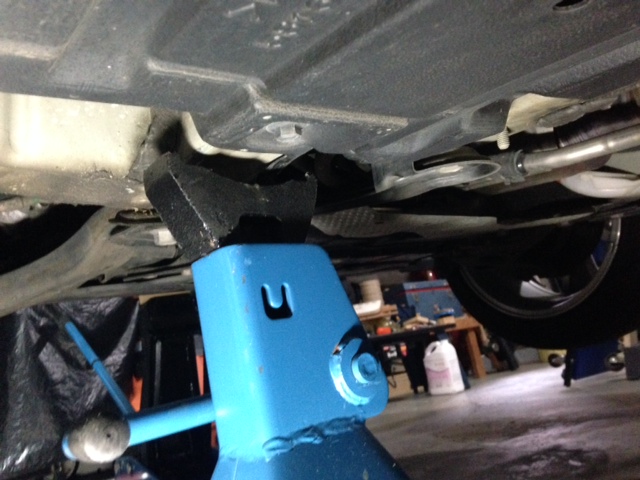

    Any of the above advice will get you on the ramps. I particularly like Greg's suggestion to raise the front end with a floor jack and then settle it onto the ramps (you could also sub. wheel cribs). I prefer jackstands, my issue with ramps being the "excitement" of running the car up them. Especially in a tight garage. OTOH, they are piece of mind personified, very stable. Anyway:
    What I do is raise the front end end with a floor jack, at the front/central jacking point. Then put in jack stands. I don't like the spec'd scissor jack location (between the 2 notches on the lower edge of rocker panel), use these points instead:
