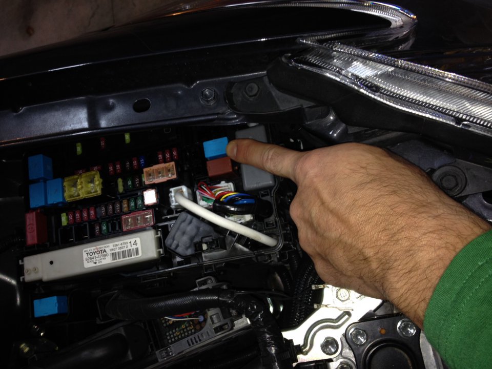

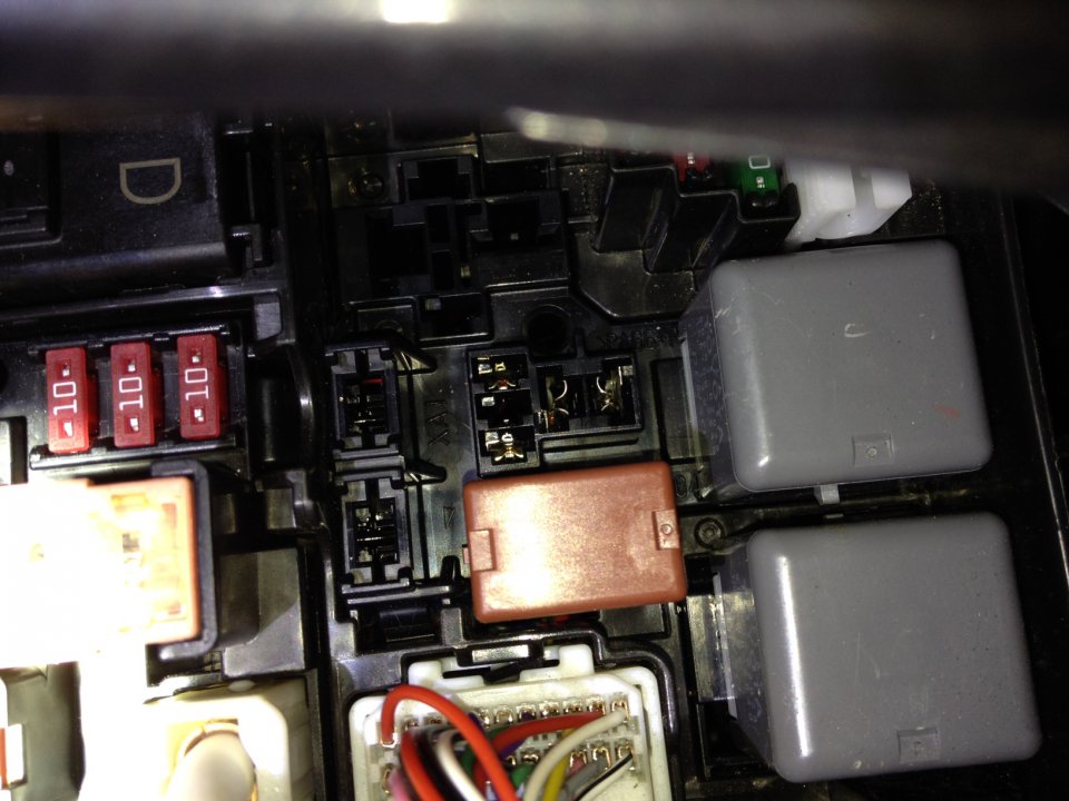

    HOLD ON YO ALL.
    You guys are taking this way far. Taking bumper off, rewiring from DRL lights to the fuses... Voiding warranty if tech will see that during the service....

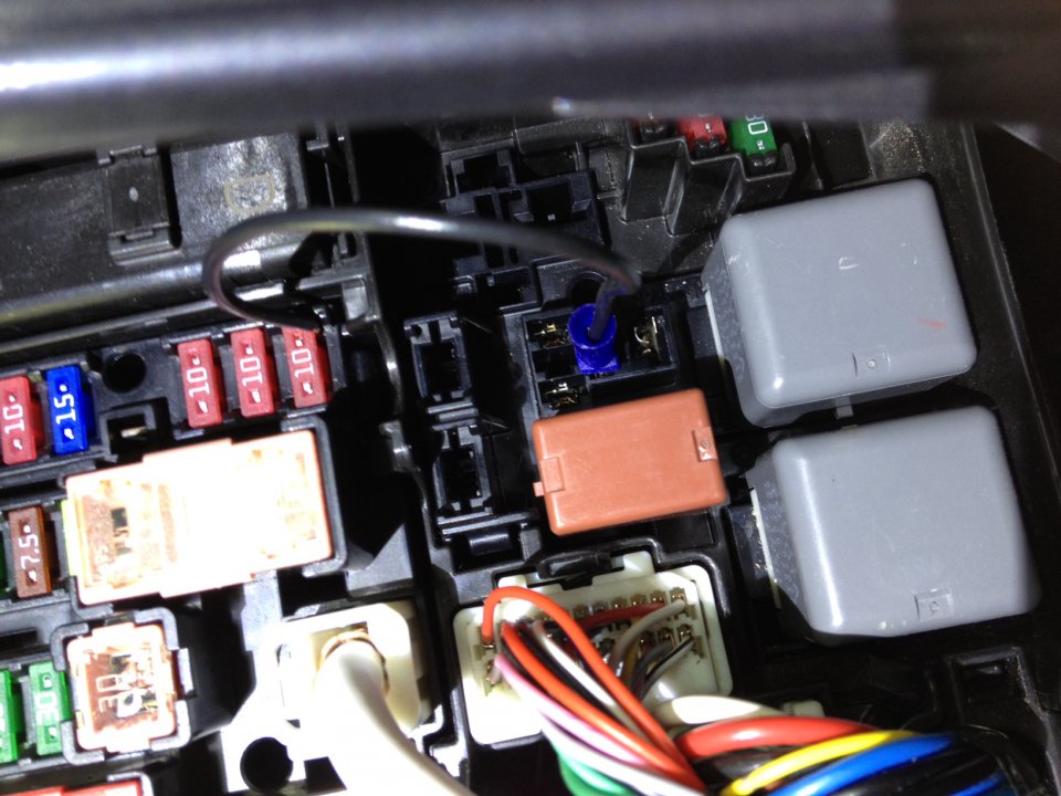

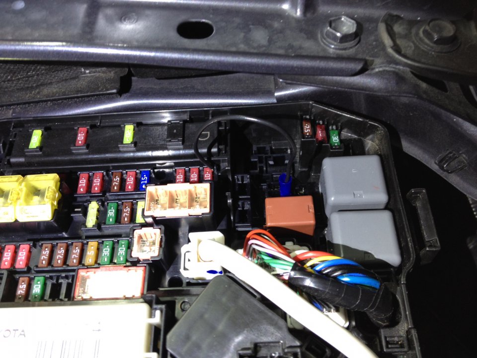

    This can be done allot easier, just by adding wire in the fuse box.
    Blue relay is the DRL relay.
    Without bypassing fuses and rewiring, I took BLUE DRL relay out and jumped the 12V plug to the lights from different source.
    Plugged wire from fuse to the center pin of the DRL relay, and here we go.
    DONE DEAL..
    You re welcome....
    NOW, here is something to think about.
    If you still under warranty, and taking your car to service, I would recommend to put it all back to normal.
    Technicians checking all of your lights functionality, checking for bad light bulbs and so on.
    If they find out of your "MOD", this can be a problem for you.
    But for now, enjoy and good luck...

  7. scooter4n
    scooter4n Junior Member
    Mar 3, 2012
    27
    27
    Only problem I see with my mod is that DRL lights re ON all the time when car is ON.
    I would like to tap that relay so DRL's can turn off when light switch is OFF, or fid DRL relay so it stays on.
    Now here is what happens, power to the coil of the DRL relay 12V + is always on, only thing switches ( turn relay OFF) is 12V- negative side of the relay coil, if some one has schematic and can trace where the negative wire from DRL relay house is going, we can fix this once and for all, so DRL lights can turn off with the light switch and everything stays on when you want it to.

  9. priuslifestyle
    priuslifestyle New Member
    Feb 18, 2014
    16
    So i did this and i got a message on the dash saying "check hybris system stop the vehicle in a safe place"
    Is there a way to have this not come up ?

    1 of 2 things happened:
    1) U pulled the fuse with the prius still powered on.
    2) when u added the wire in the fuse, the fuse didn't make full contact causing the error.
    If it's done correctly, u shouldn't have had the error.
    U can use a OBDII scanner, tech stream, scan gauge II to clear the error. If it comes back, the wire tap isn't allowing the fuse to make full contact.
