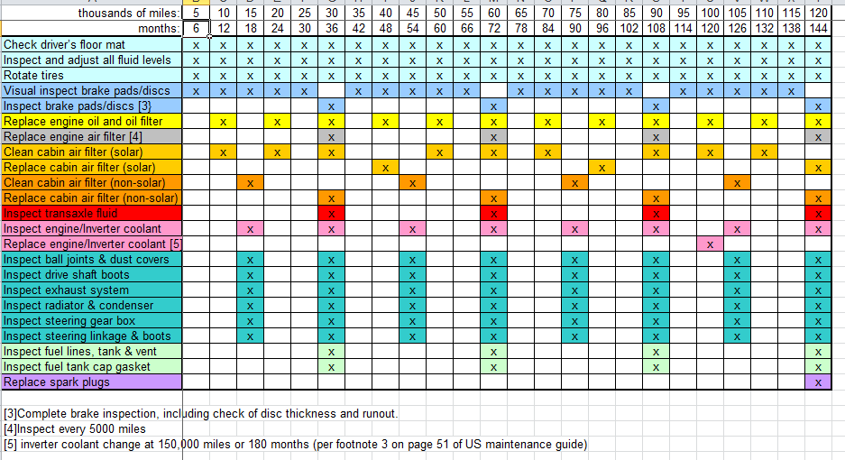

    I don't think Toyota USA has any 7500 maintenance interval:
    This is a summary of the US schedule I put together:
    I believe you're talking about the miles counter in the dash? I would just reset it when it pops up, otherwise ignore it, and follow the above schedule, by miles/months, whichever comes first. FWIW, Canadian spec Prius don't have this counter, life goes on.
    There's a few extras worth considering:
    Transaxle Fluid change (at least once, sooner than later)
    Brake Fluid Change (30k miles or tri-yearly)
    EGR system clean (every 50k miles)
