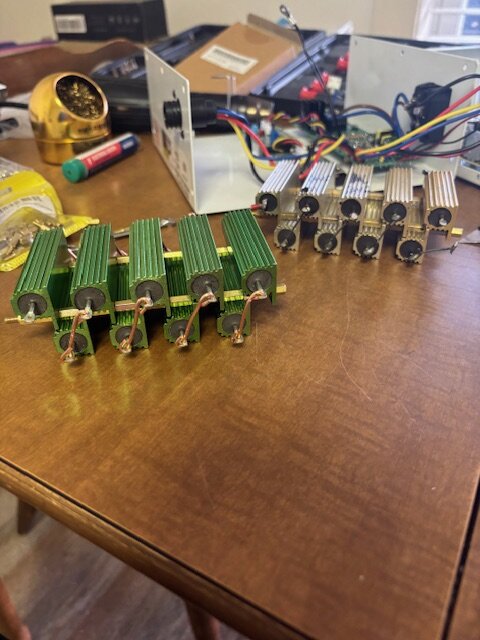

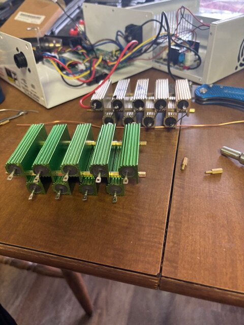

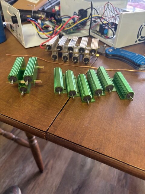

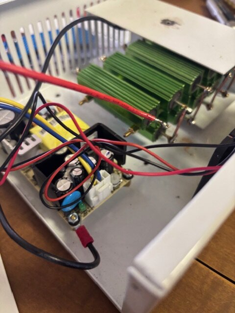

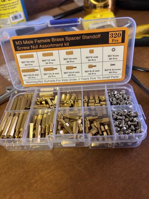

    Update on my Prolong Discharger repair:
    I received my resistors from China. In an earlier post, I mentioned the Green colored resistors were a smaller size. This is incorrect. The Green and Gold Resistors are identical except for the color.
    I assembled one 9-Resistor Bank to replace the defective one in my Prolong Discharger. I have enough Resistors to make 2 more banks as back-ups.
    I used M3 Brass Hex Motherboard Stand-offs to build the Bank (as in the original). Hex Stand-off hardware is available as a kit on Amazon. (see pic)
    I used common house wire (14-gauge copper) to solder the resistors in series.
    The Discharger has been running for one hour with no problems. If that changes, I'll report back here.
