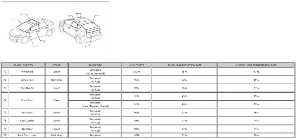

    Anyway, here's the (2010) window info:

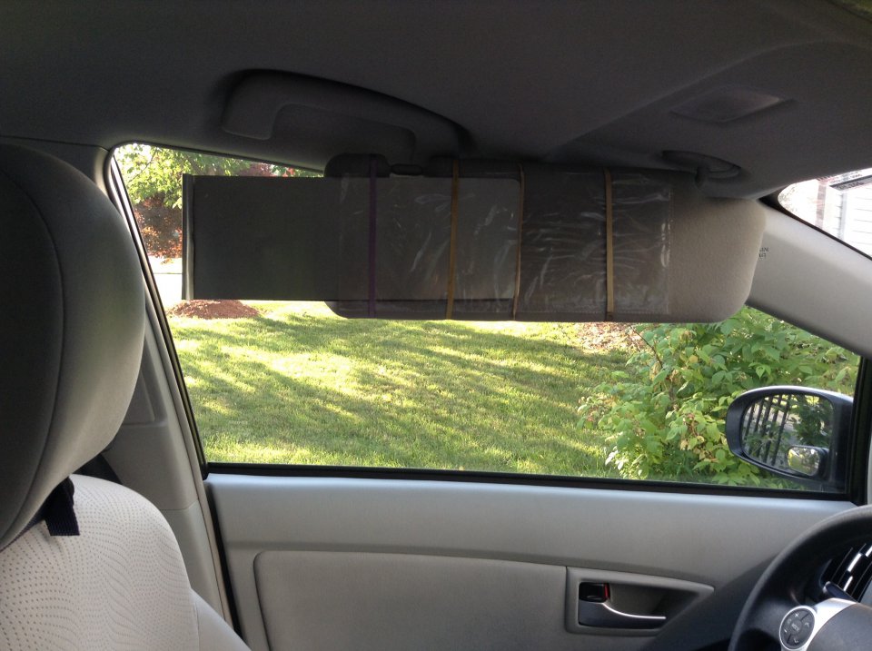

    I use a plastic sleeve rubber banded to the visor with an pull-out shade made from aluminum flashing. You could use cardboard instead , as long as it is thin enough to slide easily in and out of the plastic sleeve. image.jpg

    This is what I have thought about, but never got around to trying. Seems like I only think about it when I've got the sun shining in, and never think about it when I'm home and could actually rig something up. Thanks for the picture, Robert.
    Edit: Just looked up "visor extensions" online and found Visormates at Amazon, made for 2010 and later Prius. Ordered a set, and will post once they arrive.
