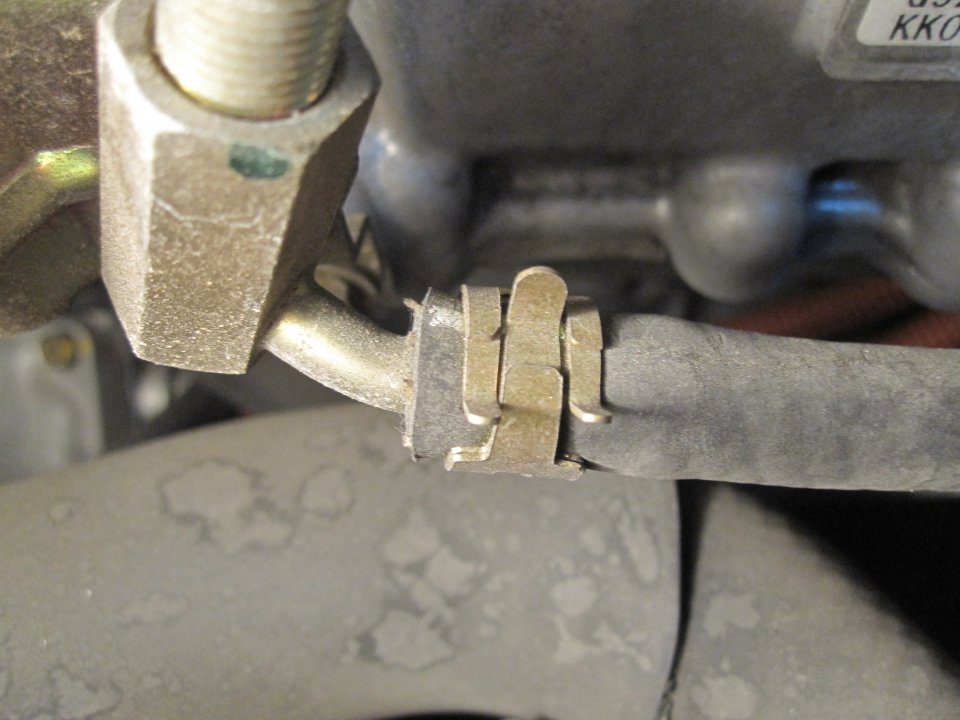

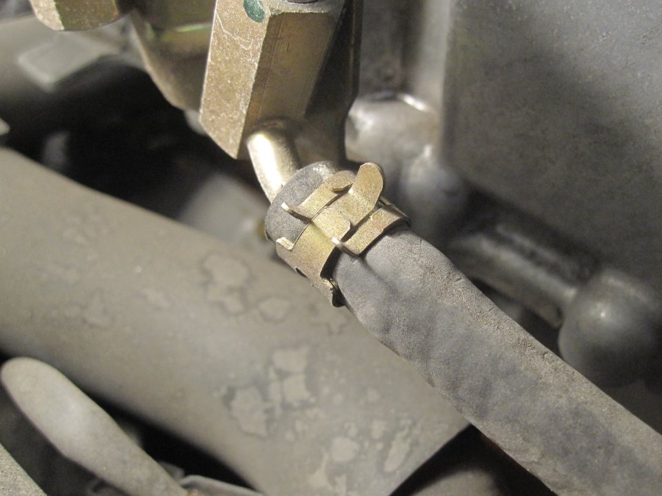

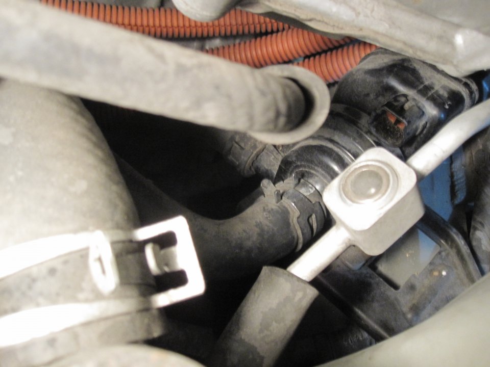

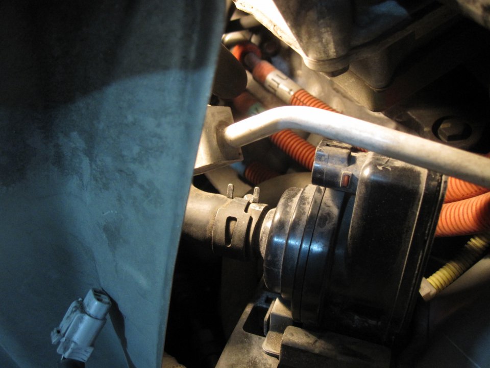

    Hello, I am replacing the inverter coolant pump and am not sure how to remove the hoses from the pump. It looks like you squeeze together the three tabs on the clamp with your fingers but it is a very tight space to work in and I can't get it to budge. Am I doing it right? Thanks

    Yes I am attaching two photos of the clamp on the hose that attaches to the inverter coolent pump from two angles. I could not get a good close up so I also took two photos of the clamp that attaches the coolant hose to the bleeder valve. It looks very similar but is smaller and it is gold in color. Also can the clamps be re-used after they are removed? Thanks

    You won't be able to do it with your fingers. You will need to use a pliers of some sort. A regular pliers will work but a water pump pliers (aka channel lock) is my preferred tool. Squeeze the tabs together and slide the clamp down toward the middle of the hose until it is completely off the nipple the hose is attached to. Then you will have to break the seal that the hose has on the nipple. I typically do this by turning the hose cw/ccw (alternating) and pulling the hose away from the nipple. They won't come off easily because they have been "heat" sealed for many years. All clamps and hoses are removed the same way and can be reused.

    I had already tried using different size pliers including channel locks but the space is to tight so that is why I was trying to use my fingers. I just tried again but I don't see any way to do it in that space. Is there some other kind of tool that might work?

    I unbolt the pump from the frame by removing the two 10mm bolts on the mounting bracket. Then swing the pump around until you can get 45 or 90 degree large needle nose pliers (harbor freight ones are good enough) onto the clamp "ears". Squeeze the clamps and slide them down the hose. You need to twist the hose to break them free, they can be seized onto the pump.
