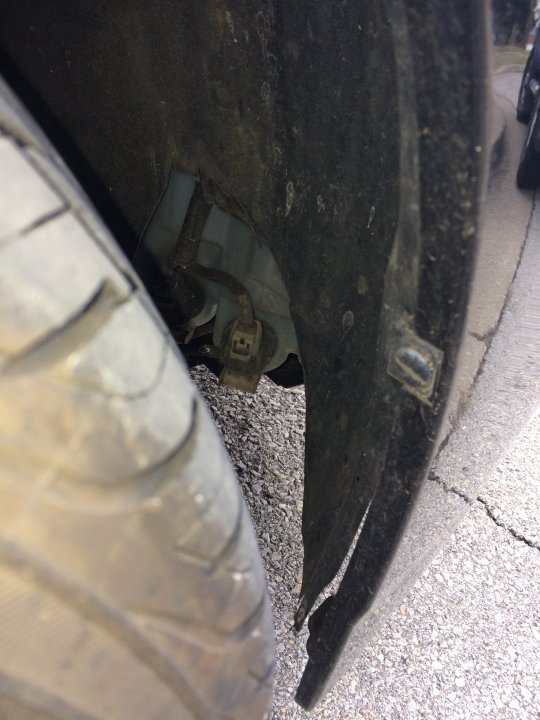

    Hello everyone. We bought a 2012 Prius Four (not IV, roman numerals were used for model year 2010) back in September, and we love it. We kept hearing a rattle in the passenger side front at highway speeds, and when we took a closer look, we found that there was some damage from the previous owner to the wheel well. I have attached a photo. It appears to just be a plastic liner. Does anyone know the part number from Toyota for this, if it can only be ordered through the dealer's parts department, and also if this should be easy enough to replace myself or if I will need to have the dealer replace it? Not only is it slightly loose and rattling as mentioned before, but the missing piece has also left the windshield washer reservoir exposed, so we want to get it fixed. Thanks in advance for any advice you can offer.

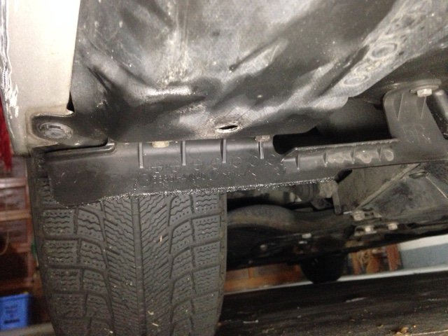

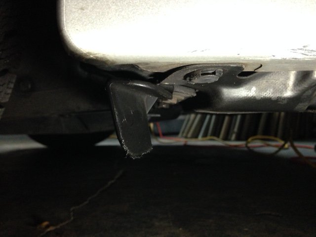

    Besides the torn wheel well liner, it looks like you're missing the front wheel spat as well. Here's some pics, side, then front view, same area on ours:

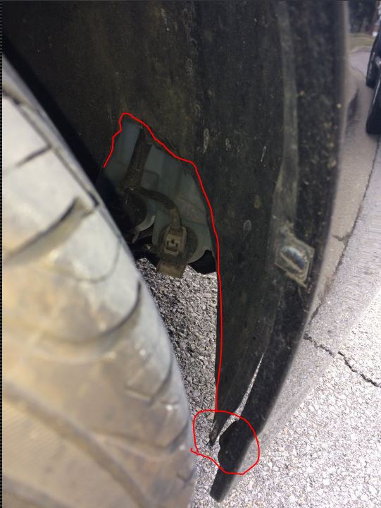

    Just marked up OP's pic a little, it looks like a portion of the wheel well cover is just gone, torn off (outlined). And there's a missing plastic fastener at the bottom (circled).
    Doesn't seem like the wheel spat's there at all. Beside the spat there's another piece of plastic filling in the bottom that seems to be missing, it shows in the front view of spat pic I posted.
    Look to see if the wheel spat bolts are still there?

    Marked up my pic, the spat bolt locations, and that other piece, the plastic underpanel.

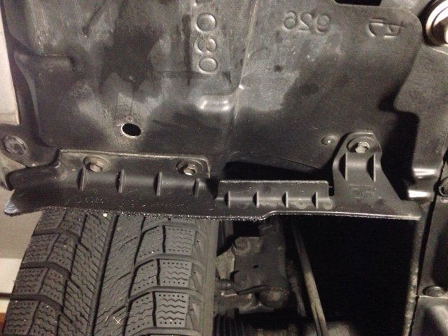

    Well, all those bolt locations will have tack-welded nuts of some sort. With any luck the bolts are still there, just the plastic has torn out. Whatever, he can compare components from the other side.
    Here's a better pic of the spat:
