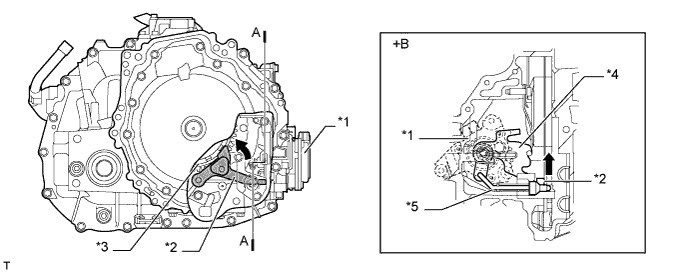

    PaJa, you said "The joystick parking position operates via PSD mechanical block."
    What exactly happens when I push the Park button? Is it anything like a normal auto tranny in this regard?

    Park drives a "gear" (looks like a "cycloid" gear from an oil pump) into a mate which locks the drive wheels but not the engine. It won't do this unless you are moving -very- slowly or you are at a stop. The computer is smarter than us drivers. ;) You can even hit it on the highway and you'll only succeed in going to "N".
    BTW, this is the only sliding gear in the car. Amazing eh? (see, I'm Canadian). :)

    as it's been said, the parking "gear" is actually just a pin.
    if you're under 8mph, it will try to drop the pin.. (maybe it was a tad slower for P)... anyway.. you'll hear clicking and feel a violent stop. if you hear a loud "ping" and you still roll, you've destroyed your parking pin/claw. (hard to do)
    as the rest of the gears (since we are off subject)... they only switch when you're under 8mph... D to R.. and R to D.... when doing 3 point turns, i don't stop, ever.. i simply go from D to R and back to D as the car rolls... it makes the prius the fastest car to turn on and do quick turn arounds in. (imo)

    No, the parking "gear" is a gear. It is driven into a mating gear that is locked (bolted) to the housing. The whole assembly is removable without full disassembly of the HSD, presumably because the engineers thought some owners might damage it easily. It looks like a hypoid gear because it's designed to not lock in position in case the car rolls against it and to ensure it can slide into position even when you'd think the teeth would interfere. Unfortunately there is no good drawing of it in the GII shop manual. Not sure what's in the GIII manual.

    Not a pin, as pointed out above. The concept is the same, but the gear system is much more robust.

  15. PaJa
    PaJa Senior member
    Sep 3, 2009
    678
    113
    92
    Czech republic
    2017 Prius
    Parking lock mechanism.
