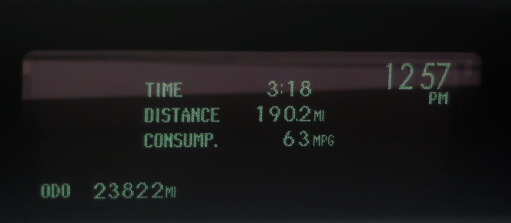

  7. CaliforniaBear
    CaliforniaBear Clearwater Blue Metallic
    Oct 9, 2012
    1,180
    289
    Northern California
    Roseville - South Lake Tahoe - Roseville 191 miles. Started with a full charge, HSI said 67 mpg probably means more like 63 mpg actual.
