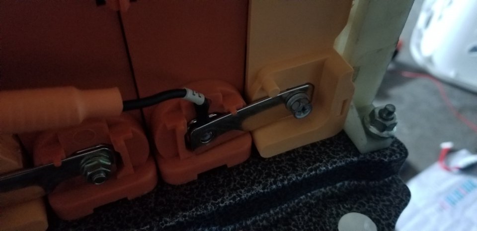

    So my nickname is the one mistake wonder. It is always one thing i screw up. I was using 48 inch lb torque but not sure what happen here. Is this weldable? Any suggestions? Im thinking about cutting the remaining small portion screw left on battery off and soldering a full screw that i cut off a bad module. Is it safe to solder onto a battery though?

    If you have old, bad cells to experiment with you can see if you can remove the stud from a cell without destroying the cell. If so you can remove the stud you broke and install one you remove from a bad cell. IMHO soldering will a)introduce too much heat, b)not hold - laser welding might but that would make it cheaper to get a new cell.

    You could also try to find a "long nut" - one which you can tighten onto the remaining part of the broken stud and into which you can also screw a "salvaged" stud. This will create an alignment challenge, but that should be easy to solve.

    I didnt think of this. I can technically put the same long nut in the module next to it to fix the alignment issue. But the rectangle piece that connects the 2 modules would both be touching only the nut and not flat against the battery. Would that cause an error?

    You'll get different opinions on this, but in my life experience as long as you have a strong metal to metal contact there is no relevant measurable effect on conductivity with "extra metal" in the path. Now with microelectronics it's different..

    So i put in for the time being like so and drove for 40 mins with no codes popping up. So I leave it be like this until a code pops up or better to do the long nut thing. Did some Dr Prius test too but i dont know if they are accurate, mean any thing, and i feel like i get mixed results with 101%(somewhat understandable as it was a new battery bought 2 years ago before sitting for months due to Cadillac theft) but a weak module 11, err idk how to process both of that.

    Is that terminal connection secure, or just wedged?
