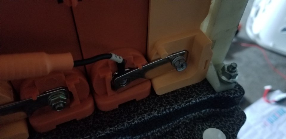

    I literally couldn't do anything for the time being as as nothing sticks out on this side so it is wedged in the remaining portion and cant come out.

    Why not drill a hole and thread where the temperature sensor enters the module? I think theres more strength there. And i dont think every module has a temperature sensor in it. Only 3 modules out of 28 have a sensor going in.

    Pretty sure there are no temperature sensors that go in any module. The three sensors sit on the outside if I'm not mistaken.
