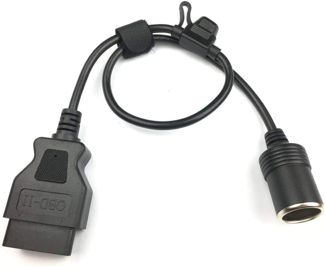

    For the OBD-II to cigarette lighter, I use the following:
    Code:
    https://www.amazon.com/gp/product/B08F5H63PR/
    OBD2 to Cigarette Lighter Female Connector Vehicle Car Constant Power Cable 16AWG Safely with 15A Fuse
    $19.88

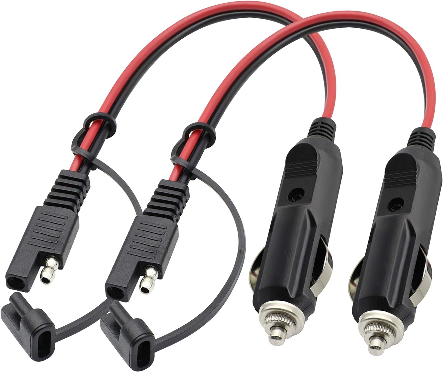

    For the SAE Quick Release to Cigarette Lighter adapter without a Power indicator LED:
    Note, make sure it doesn't have a power LED, they may change the Cigarette Lighter adapter style.
    Code:
    https://www.amazon.com/AAOTOKK-Cigarette-Disconnect-Connector-1ft-2Pack-M/dp/B0813NRYMC
    AAOTOKK SAE Cigarette Lighter Charger Cable,16AWG 12V Cigarette Lighter Male Plug to SAE 2 Pin Quick Release Disconnect Connector Plug Adapter Extension Charging Cable with Fuse(0.3m/1ft-2Pack-M)
    $8.99
