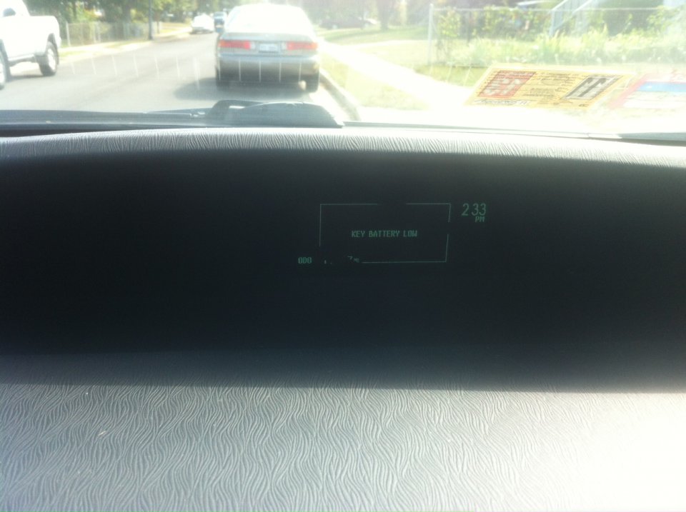

  4. PriusGirlyGirl
    PriusGirlyGirl Junior Member
    Sep 14, 2009
    37
    Washington DC
    So, I have less than 20,000 miles on my 2010 3rd Gen Prius. I got that message of Key Battery Low on my dash a few months ago and continues to appear however it only appears after about 10 miles or more of driving! I took it in to the dealer (for the brake booster recall fix) and they could not replicate the low key battery warning. I bought new batteries to replace in my key fob (on Amazon, 5 pack for just a few bucks) and the warning still does not go away! It's the strangest thing. I wonder if there is something internally wrong with the sensor in my car. However if the dealership doesn't even know what's wrong I'm not sure who would? My original key battery lasted for about 3 years. I only changed the battery a few months ago and I've never had trouble starting the car. I also keep a spare battery in my gym bag and glove compartment just in case the current on in the key fob fails. I just hate the uncertainty of whether the actual battery is not fully charged OR if there is something wrong with my car. :(
