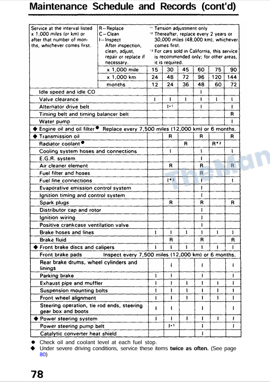

  12. Mendel Leisk
    61,529
    42,343
    You've got that right:
    from: honda-accord-sedan-1990-owners-manual-linked.pdf
    With the caveat, "severe driving conditions", halve the intervals. Too, the "or 6 months" is presumably whichever comes first.

    ----USA----
    Wow transmission fluid at 30,000 miles?
