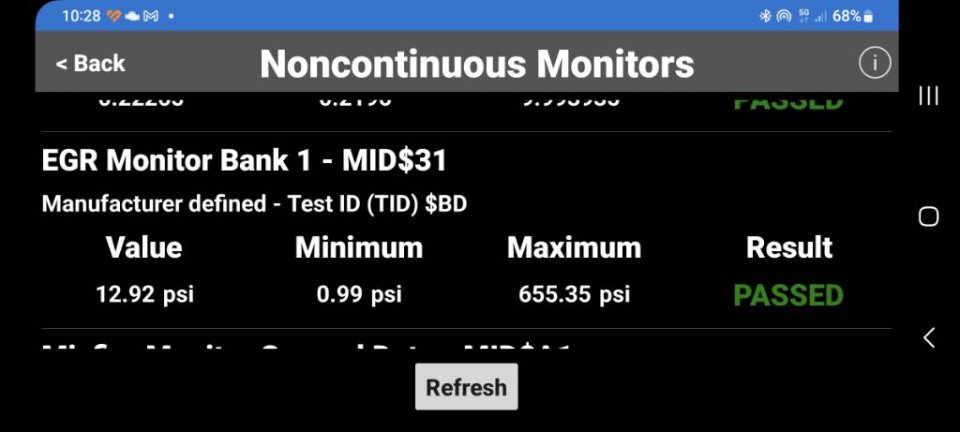

  12. taxidriver50005
    taxidriver50005 Active Member
    Jan 3, 2017
    204
    170
    GB
    Excel
    I had never used the car scanner app before so hadn't a clue on what's good and bad on the flow side but here goes, 204520 miles since last EGR clean.
    CR94 and Bill Norton like this.

  19. ChapmanF
    27,489
    18,080
    OK, 12.92 is getting down there. Squeaky-clean is usually up around 21 or 22. Mine was down to 10 point something before I cleaned it. Yours might be about due again.
    Of course it can still go a lot lower before hitting the failing value and setting P0401. Whatever you're comfortable with.
    Another possible cause of a low test score is a mashed ski jump in the EGR valve rotor. Also worth checking.
