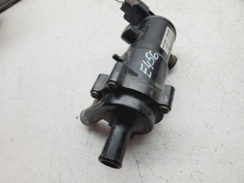

  15. TeslaCoils
    TeslaCoils Junior Member
    Mar 28, 2021
    Ohio
    under the rear of inverter is a pump (I'm doing an ABS/ ReGenerator) 064100-00951
    14 vDenso Made in Japan
    Has a few names
    Water Circulation Pump Cooling
    INVERTER COOLANT PUMP
    21:50 how to remove connector clip
    https://i.ebayimg.com/thumbs/images/g/SJcAAOSwTs5k56N2/s-l500.jpg
    All 4 shown:
    #15 TeslaCoils, May 30, 2024
  16. mr_guy_mann
    mr_guy_mann Senior Member
    Sep 3, 2020
    4,113
    2,011
    NJ-USA
    That particular pump is to circulate coolant through the heater core when the ICE is stopped (and the HVAC ecu calls for heat).
    FYI it is not part of the inverter cooling system.
