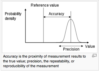

    Accuracy measures the average value of a series of measurements against the true value.
    E.g, consider a device that results in a continuous circle of even width (implying no point on the circle is more frequently hit than another). If the true value is the origin of the circle, the accuracy of the device is perfect. The radius of the circle does not matter.
    This is why accuracy and precision are both reported.
    From Wikipedia, a very nice math description in a graph:
