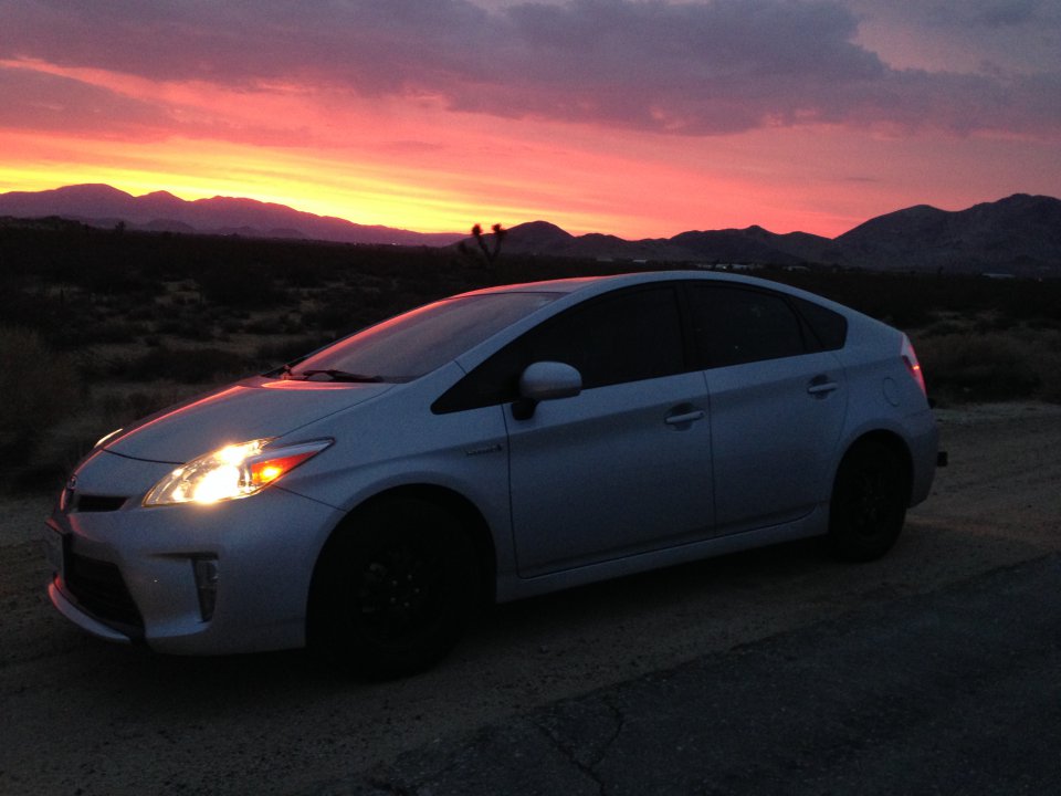

    Ceramic tint Llumar FormulaOne - i did 11 windows for $310. front driver/passenger @35% tint and all the rears at 30%. the front windshield was another $150 for that and i didn't want to spend $500 on tinting. This picture was taken last month in the high desert in Mojave, California. it was around 9:00 and still in the 90's. The desert heat is hot in the summer (no kidding) ask anyone from Phoenix, so ceramic does the best job at IR rejection without going super dark. The picture is deceiving but the tint looks pretty close to factory. The optical quality is nearly perfect and the tint is guaranteed for a lifetime and is transferable.
    The person above that posted - the ceramic cuts out most of the heat in the cabin, ditto for the winter. Dyed plastic tint, the type you pay under $200 doesn't cut out as much, but the darker you go the more heat it rejects and the more light it blocks. 15% tint lets in 15% of the light... what i don't like about the dyed tints is the color of the film. they are either blueish tint as in Medico (which was my second choice) they do this on the front windshield at 80% if you tint the front.
    3m Pinnacle i believe was a grayish bronze and other tints are green grey or some flavor of bronze, grey, gold, green, etc....
    if you every look at a Tesla that has been tinted, they usually spend the money on a ceramic tint, and it makes the car cooler in the cabin by a huge margin over no tint. it was a tad expensive for a prius, but i shopped around and saved $140. So instead of $450+ i got the 11 windows tinted for $310. I really like the tint... it was the best upgrade to the car.
