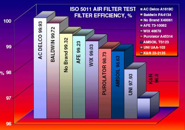

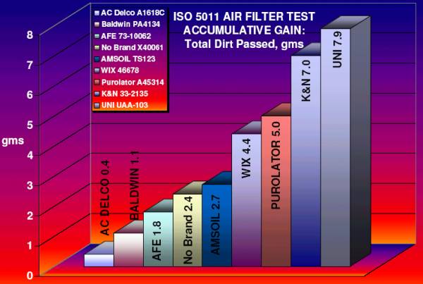

    Ahh, fell for K&N marketing.
    Read the following link in its entirety (its not long). Its an objective test performed on nine air filters, one being a K&N.
    http://www.nicoclub.com/archives/kn-vs-oem-filter.html
    "However, if a filter is using “better airflow” as their marketing tool, remember this….Does it flow better? At very high airflow volumes, probably. BUT, our engines CAN’T flow that much air unless super-modified, so what is the point? The stock filter will flow MORE THAN ENOUGH AIR to give you ALL THE HORSEPOWER the engine has to give. And this remains true until the filter is dirty enough to be recognizeable. At that point performance will decline somewhat. Replace the filter and get on with it."
    Filter Efficiency (How well does the filter captures debris.)
    Accumulative Gain (Total amount of dirt that passed through the filter.)
    These two graphs speak volumes. If you logically think about K&N's premise: increase Horse Power by increasing air flow. The less restrictive the air filter, the greater the air flow. Unfortunately, more debris will be passing through the air filter (as shown above), into the intake manifold, then into the cylinders. Even if no cars are ever damaged running K&N air filters, is the cost of the filter, filter oil, filter cleaner, and required maintenance of these filters require, worth K&N's claim of 1-4 Horse Power increase?
