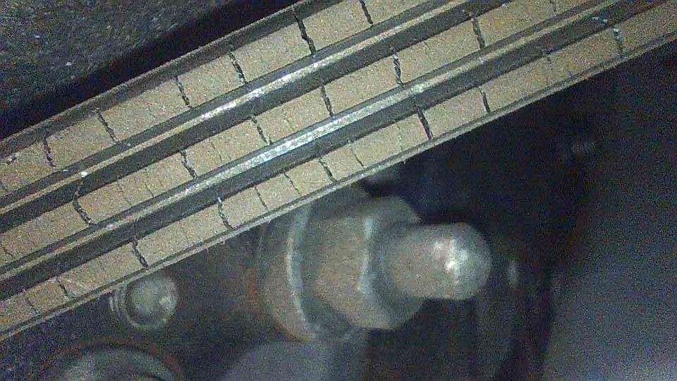

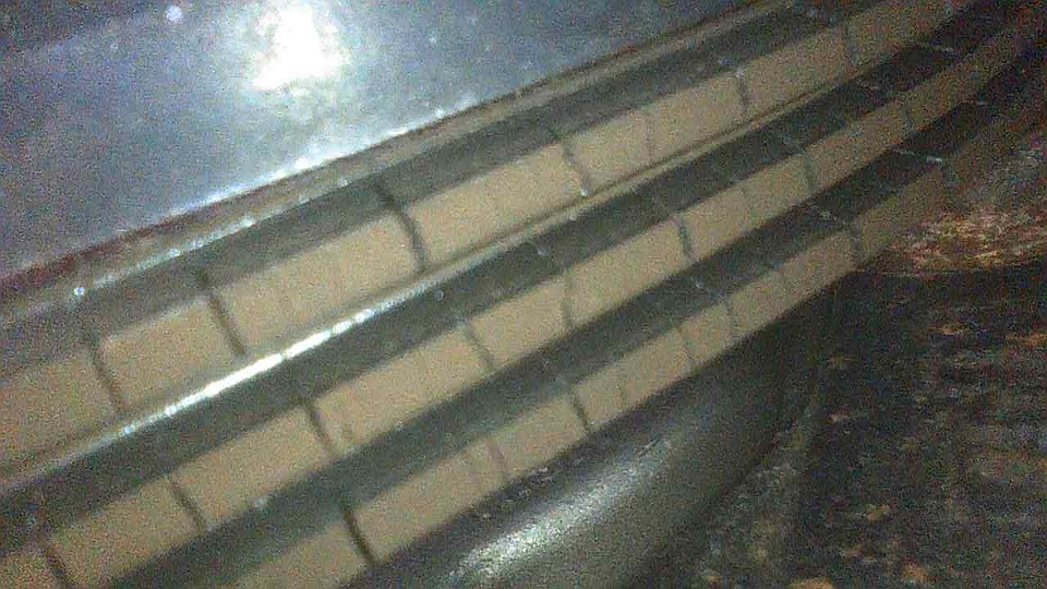

    Took a couple of pictures with the cheap Teslong endoscope. The first picture is from the coaxial camera (looking down, I think on the section where the belt is contacting the pulley on the pump, which is the grey metal above it), the second from the sideways camera (looking up, on the free section of the belt before the tension pulley [I think] before the pump). Lots of cracks but no chunks missing. The belt is about .42" wide, and it looks like around 5 to 6 large cracks per inch. The cracks open up a bit when the belt is on the pump, as that bends the belt backwards slightly. Guess I'll change it when I get back from a visit to the Bay Area. Hopefully it has another 1000 miles or so of life left in it! Also looked around the water pump and there were no signs of a leak, which is consistent with the observed zero coolant loss.

    Wouldn't hurt to replace it. It's pretty easy to do; loosen 14mm pulley bolt (no need to remove) then adjust the pulley up/down with 12mm.
    That said I think my cracked belt lasted for years. When you feel how easy it is to spin that water pump, it's little wonder you can get away with trashy belts for so long. There's no alternator or power steering or A/C compressor to create load in general.
