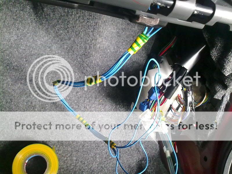

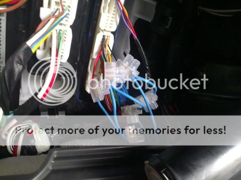

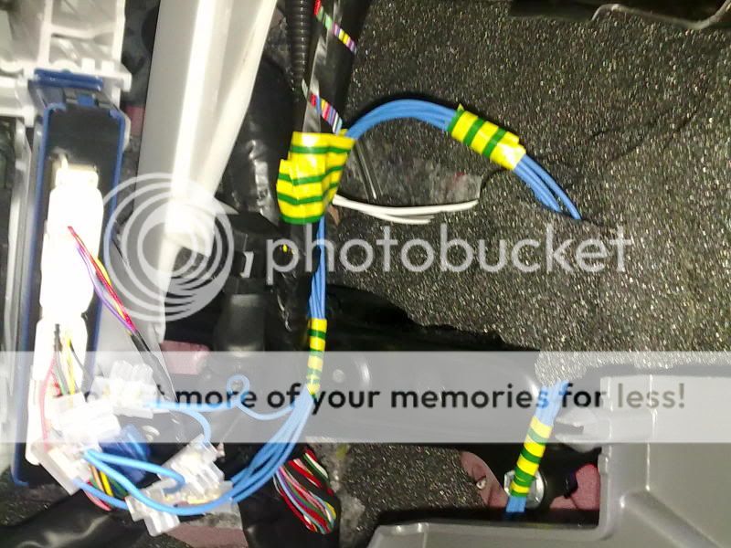

    Some pics of the install:

    Fixed.
    It was the blue wire. One of the tapewires had failed and the wire had lost, maybe due to a bump on the road.

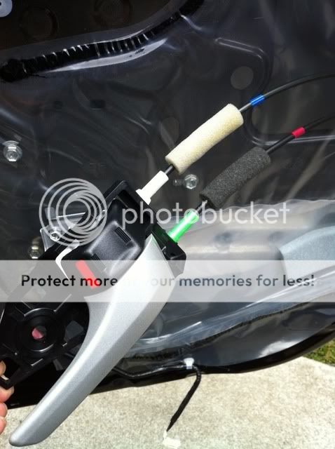

    Second, in the write up, there is a part about disconnecting the cables to the door handle and lock by pinching connectors out of sockets. Not sure with the 2010, but the 2011 I did not not to remove the cables out of the socket, the entire plastic frame that holds the handle and lock switch easily pops right off with a little nudge.

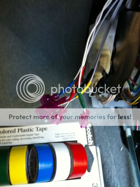

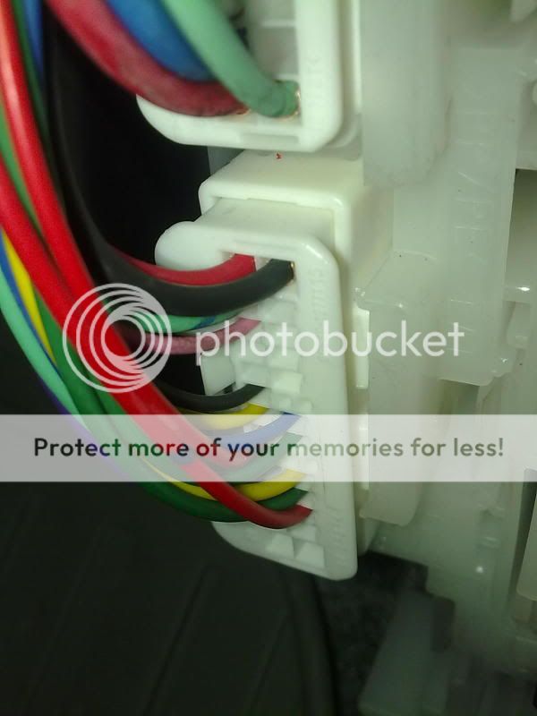

    Third, make sure your T-taps are actually tapping into to the ECU wires. I used a multimeter and found out the the blue wire was showing 12V but the Yellow wire was 0V. So I wiggled the T-tap connected to the yellow and the handle came alive.
    Forth, BrettS already warned about this but I want to reinfoce, that if you cut the white wires make sure you at least label the wires. I used colored 3M tape to mark mine.

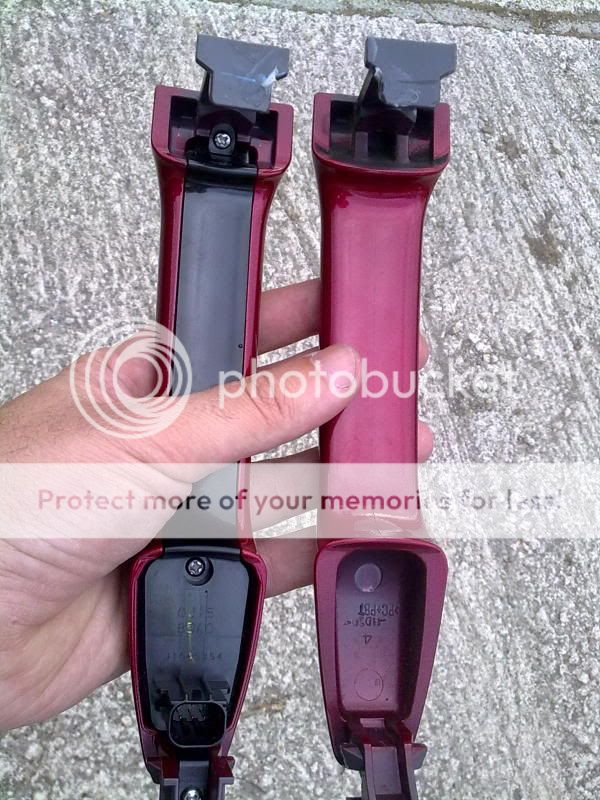

    ALSO Does anyone have a close up of the handles. It is hard to see on the pdf. it looks like these are the handles to unlock and lock from outside???

    These are both original (right) and mod (left) handles.
    The new handle already installed:
