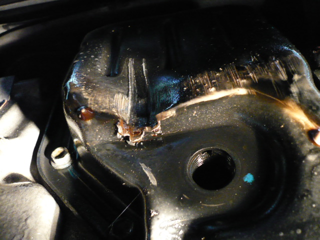

    Not necessarily. It may just have been the last nail in the coffin. Here's the story from the fleet manager. Tremblay is their service provider and the car was brought to them with some kind of transmissions problem. The tech entered "transmission wonky" an it was decided then to take it to the dealer:
    I wish I knew when the plug was pulled. So far, it's a mystery.

    Sorry, I forgot to mention the ground fault interruption system. If the resistance to ground of either side of the traction battery falls below several megaohms, it takes power off of the three safety relays to isolate the traction battery on each end and breaks the middle. The system is so sensitive that an electrolyte leak will trip it. You never want to do anything to compromise the insulation and I believe the main power cables are shielded.
    A photo of the pan would help but I can imagine someone driving over a curb or rock in such a way as to loosen and start to unscrew the plug. Once loosened, the oil would leak out and vibration would cause the plug to unscrew and drop off. Loss of oil and the rest is burnt toast.

    In a way, I suppose it's a good thing because it's not an MG2 failure/manufacturing defect, just a accidental loss of fluid. One less negative reliability statistic.

    Update: The tranny died of thirst for sure:[​IMG]
    Slow leak through that tear...Fast leak out the drain.
    Happened to me once in my beetle. The oil drain plug let loose "for some reason" *ahem* and I lost 6 litres of oil in 100 feet. The oil light saved my engine and luckily a fire truck passed as I was stopped and cleaned up my mess.:redface:
