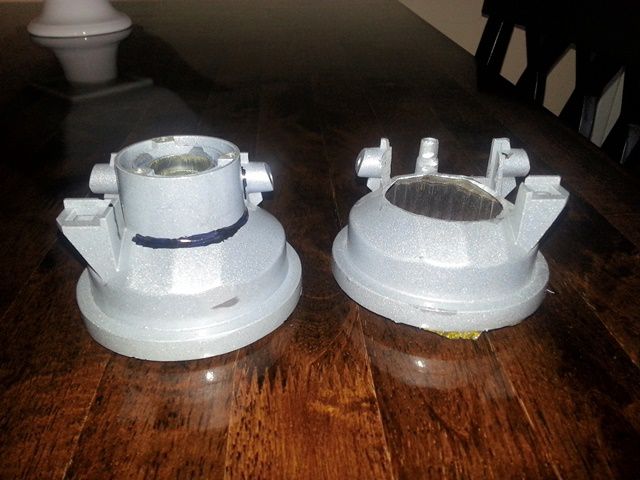

    You could always retrofit like I did... Hella Micro De Fog Light Retro-Fit | PriusChat
    Or...Go with some Yellow lens fog housing...
    Which is what I did on my 2007 until I get my new Hella fogs mounted.
    I did bake my fogs in the trial run retrofit - had i been more patient it would have worked, however i got hurried and slightly chipped the edges of the lens while lifting it with a screwdriver. I ended up having glass cut to fit the lens and went on my merry way.
