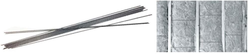

  13. StarCaller
    StarCaller Senior Member
    Feb 15, 2014
    1,284
    733
    Cedar Crest, NM, USA
    like this one here?

  14. Mendel Leisk
    61,535
    42,347
    I used coax cable wire, the skinnier kind. Deburred the nipped-off tip too; otherwise it tended to snag.
