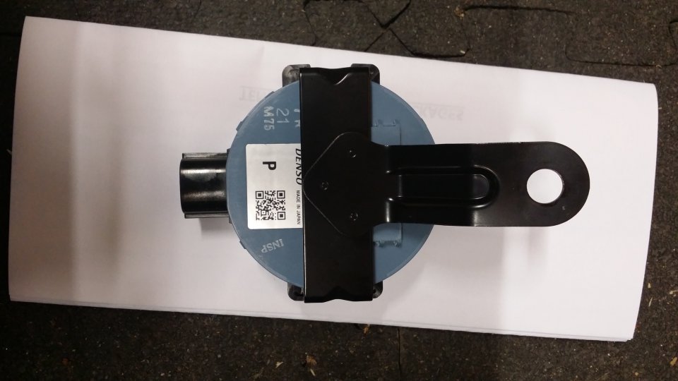

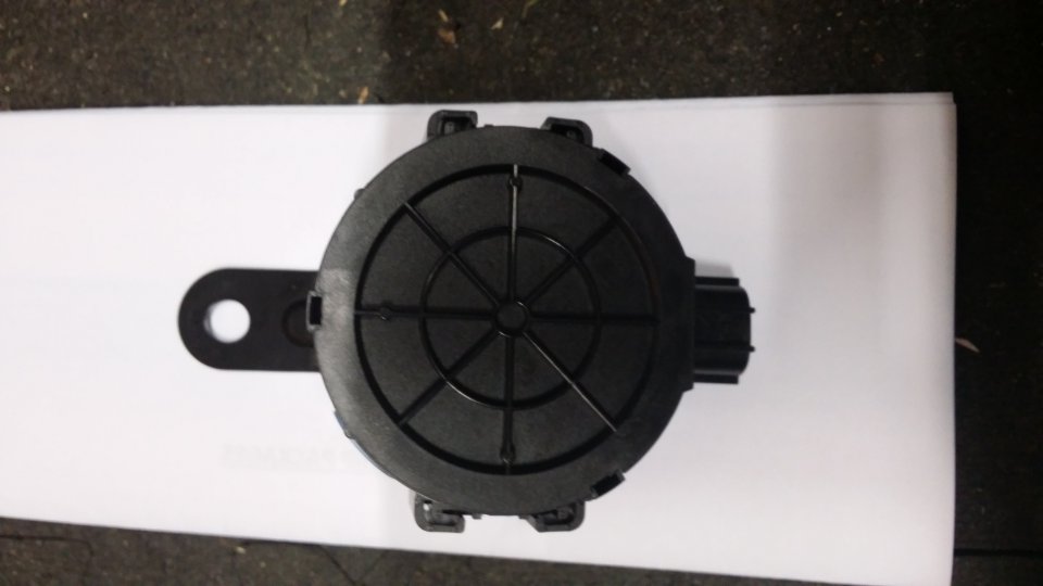

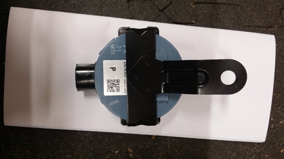

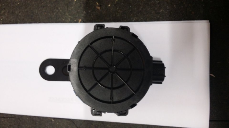

    Is this the right part that makes the noise? Toyota part number 86570-47011. toyota20141003_164755.jpg toyota20141003_164803.jpg
    Thanks,
    Andy
  4. bisco
    115,530
    52,915
    it looks like it, but i'm not positive.
