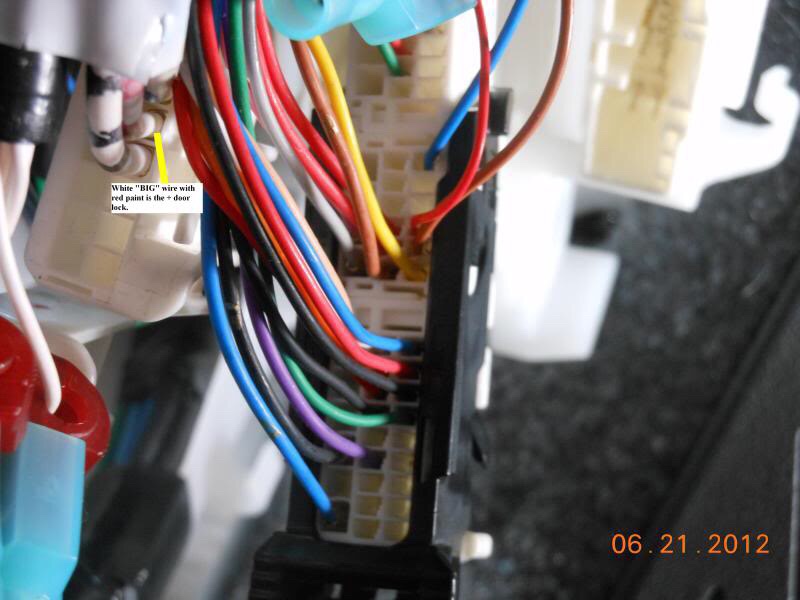

    Hi where is the lock and unlock trigger located? do you have picture?
  7. sfv41901
    sfv41901 Masta S
    May 5, 2010
    4,591
    5,293
    Palmdale, Ca
    Since ur in SF I'm going to assume u have a LHD Prii, :D the lock signal is on the drivers kick panel junction block

  8. dajackal415
    dajackal415 New Member
    Mar 8, 2016
    San Francisco
    hi how bout the unlock signal ?
    Dylan Doxey likes this.
  9. sfv41901
    sfv41901 Masta S
    May 5, 2010
    4,591
    5,293
    Palmdale, Ca
    The wht w/ Blk strip right below it
    iPhone ?
  10. dajackal415
    Mar 8, 2016
    San Francisco
    hey its on the passenger side right? lol
  11. sfv41901
    sfv41901 Masta S
    May 5, 2010
    4,591
    5,293
    Palmdale, Ca
    Driver side
    iPhone ?
  12. dajackal415
    Mar 8, 2016
    San Francisco
    thnks a lot for your help . it works now..peace

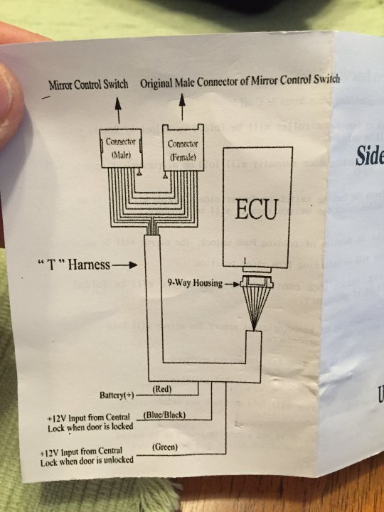

    My understanding is I would need to buy the signal mirrors AND Wish motorized mirrors (plus harnesses, switch of choice, etc.). The guts of the Wish mirrors get swapped into my factory mount and signal mirror. Correct?
    I’d still have the ability to extend the mirrors with the car parked and doors locked by using the ‘swing’ button, but the car would need to be in accessories mode. Correct? This is important to me for when I’m parked waiting to pick someone up and the mirrors give extra views, or chow fast food in sketchy areas.

    Correct. The Wish Mirror motor gets swapped into ur OEM Prii housing. They do come complete with the controller & switch.
    As long as u are in accessory mode or in ready, the doors can lock without the mirrors folding. If u push in the switch they will then fold. Once u power down & the doors lock the mirrors will fold.
