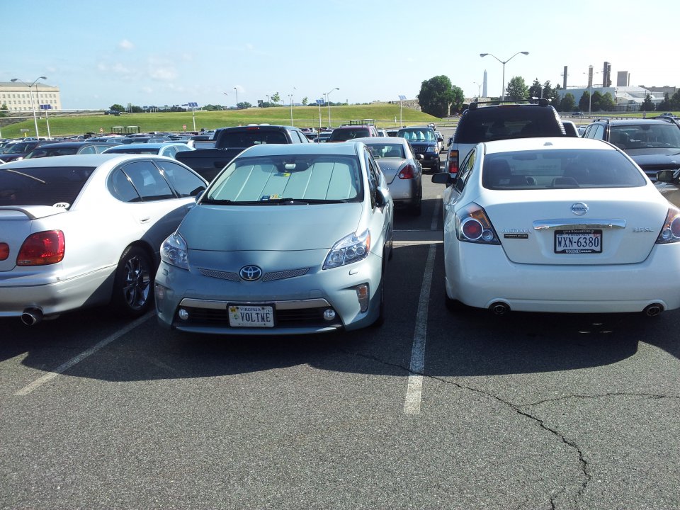

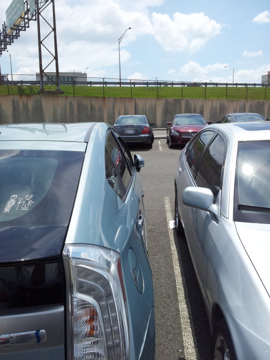

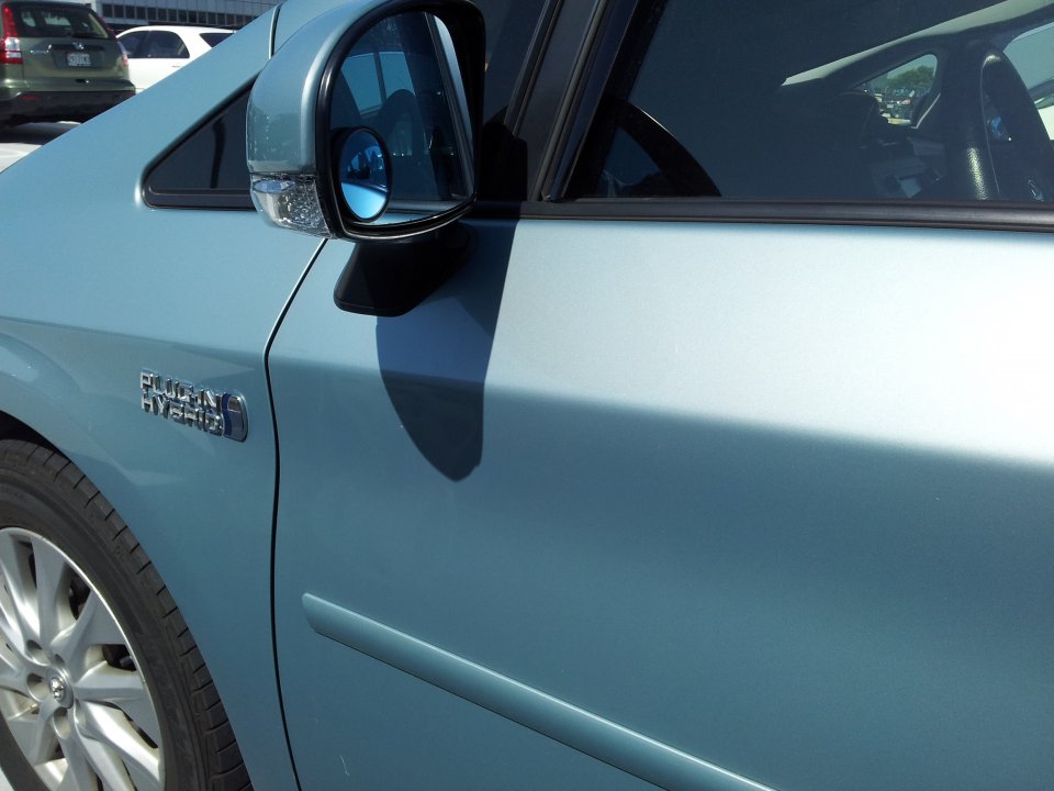

  5. DadofHedgehog
    DadofHedgehog Active Member
    Jun 17, 2012
    681
    282
    northern Virginia

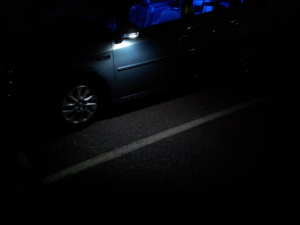

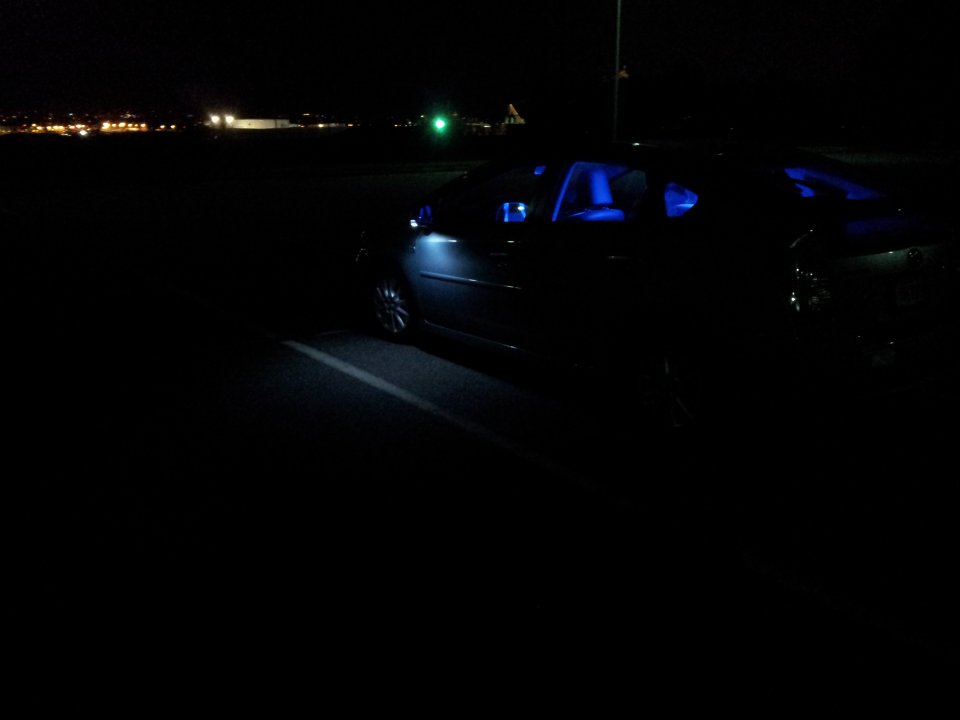

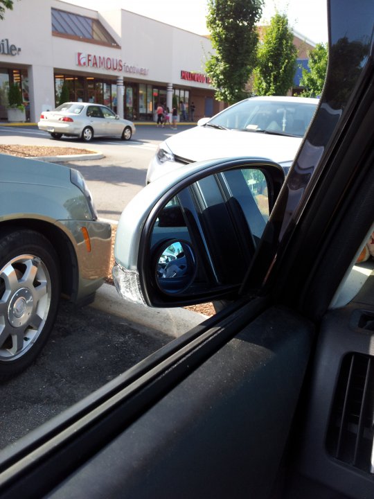

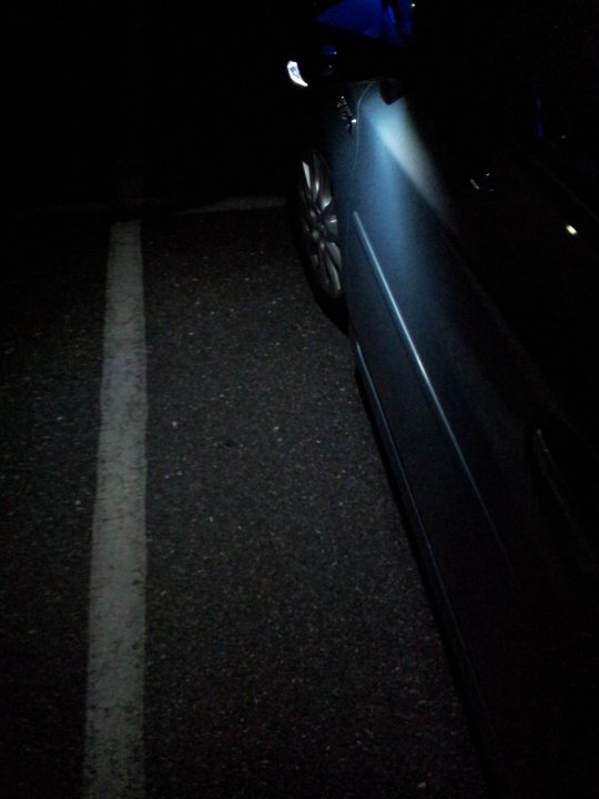

    [/QUOTE]Let's see a pic of the new install...:)[/QUOTE]
    Here are the pix. Unfortunately most of the night ones came out badly because the camera on my Galaxy S II (or the cameraman) has a hard time focusing onto flashing turn signals at night in dimly lit parking lots.
    The night puddle lights are surprisingly useful. You can also judge for yourselves how very useful the folding JDM mirror feature is in a tight parking situation.

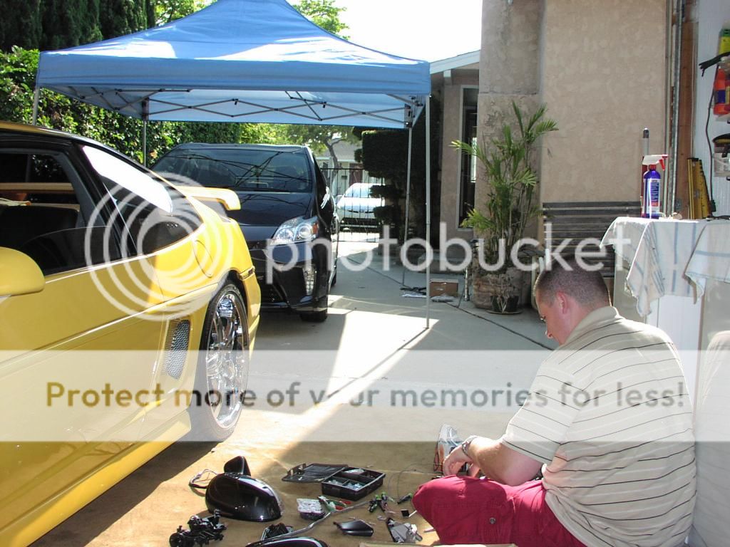

  7. DadofHedgehog
    Jun 17, 2012
    681
    282
    northern Virginia
    Awesome with use of your install video... and a cold beer or two out on the driveway on a warm summer weekend ;-) although I did curse the car gods when tryin' to sneak the wire bundle from the left side to the right side, upside down on my back under the dash... reminded me of working on my '66 Mercury Comet back in the very early 1980s.
