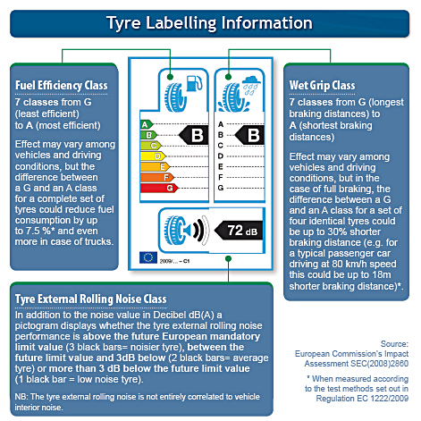

    LRR is an abbreviation for low rolling resistance. The theory being the lower the rolling resistance of a tyre, the less energy required to push the car along and therefore the less fuel used by the vehicle overall.
    Each tyre brand generally uses their own trademark to signify LRR e. g. ECO, Energy Saver, etc.
    Using the EU tyre labelling you are looking for the first letter (fuel efficiency) to be high as possible preferably A, and in concert the second letter (wet grip) to be also high as possible, preferably A also.
    As noted in other posts, the EU labelling system is limited as it seems the manufacturers themselves assign the rating. Having said that it is still useful. There can be variance when comparing tyres by different manufacturers in that one manufacturer's "B" might actually be better than another manufacturer's "A", probably due to a difference in interpreting the testing criteria. It is important to also check the user reviews, preferably by people in your own country to get a feel for how a particular tyre does in real life.
