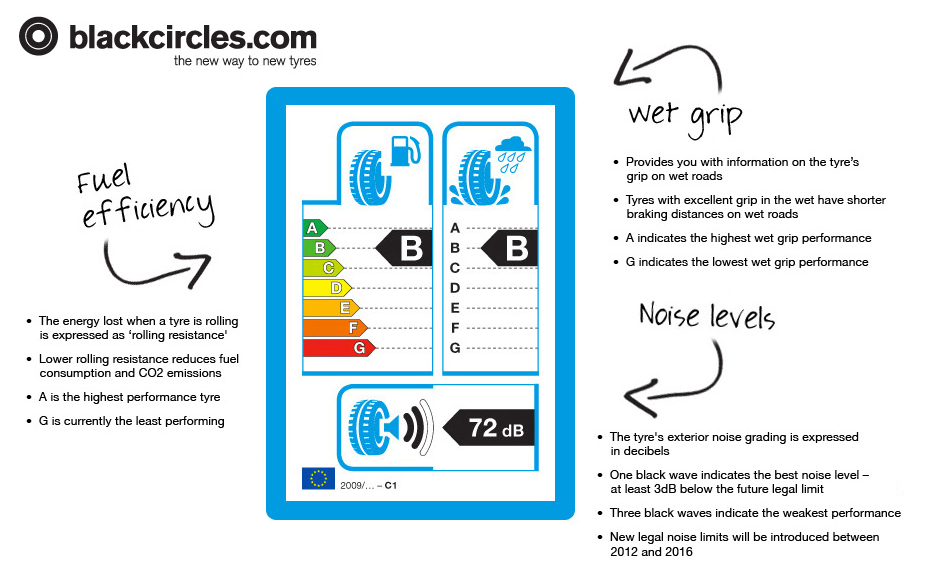

    IIRC Europe has a standardized rating system for LRR tyres.
    I'm not sure though how to be sure that the tyre sold in Europe is the same tyre sold in N. America
    Addendum: this
    Closer Look at the EU Tyre Label | Blackcircles.com
    Each grade down in fuel economy is about 1% more fuel consumption
    Each grade down in wet grip is ~ 3 meters longer braking distance
