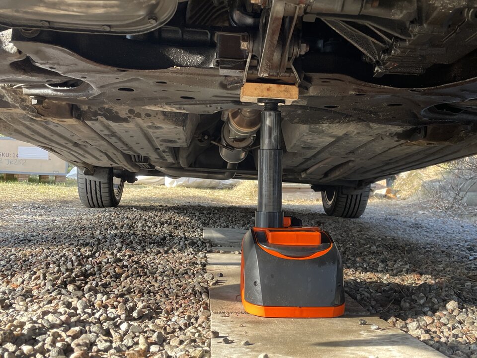

    This is how I unofficially lift my gen 2s, with a lovely banal Vevor remote controlled 21V pneumatic jack.
    The package also includes a 450Nm lug nut wrench device. Price is apx 200usd for the bundle.

    I use a simple floor jack for a quarter of the price; break loose the lug nuts and use my drill to half-inch socket adapter to run them in n out; because you need to torque them down when your finished.

    Most people use a floor jack. Me to before for 20 years..
    It’s not all price, it’s convenience. When you have three cars that need winter tires, this is super fast and smooth.

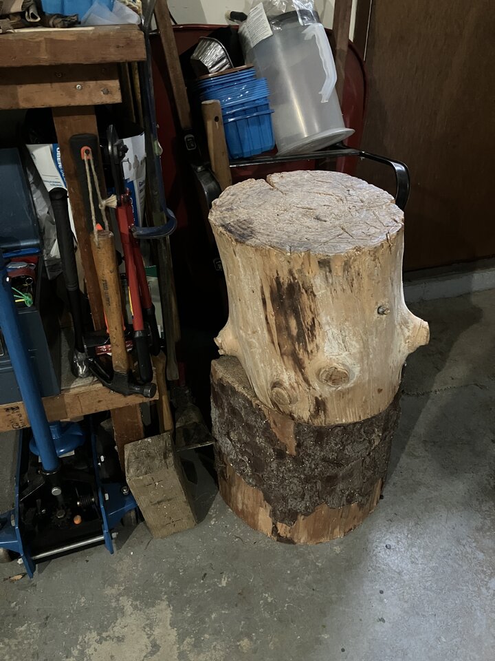

    My other trick, whenever practical: push a tree trunk section under there, before I get under.
